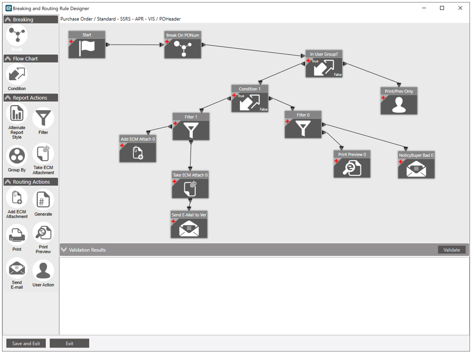

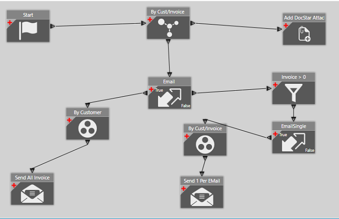

I have not tried Auto-Invoice, but you may need to define the Routing and Breaking on the Report Style. You define how you want the report routed when it is printed, and can design the workflow to distribute internally and to Customer Email address etc.
Enable Routing and Breaking rules and define the workflow.
