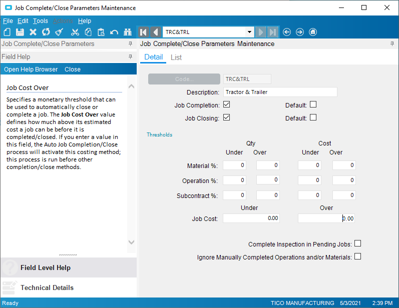

Auto Closing Parameters
I did some searching but did not find extensive answers on what these parameters are referring to. Can anyone explain how the values apply to jobs? I’m not in job costing so a majority of this stuff is Greek to me. I was asked by our Controller to setup a 20% across the board, This is what we entered, but I’m not sure if it’s correct or not. We’ve been testing it on our training DB and I have seen this process automatically complete, and then close 3 jobs that are not marked as complete. Any idea why it would do that? I do not have any auto complete parameters setup or applied to any product groups.

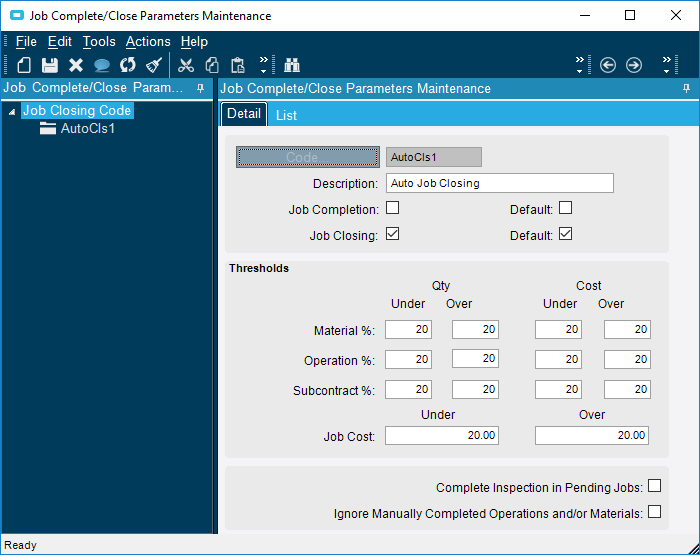

In some of the testing I have done, I found that if you have all those items populated then it is quite strict, and the individual line items will overrule the Job Cost as a whole. It seems like you would have to pick which one is more important, the individual items, or the job as a whole, at least in relation to auto closing.
In my first test with all items listed at 20%, it closed out 98 jobs, 3 of which it also auto completed and closed, they were not marked complete prior to running the auto close process.
My second test with only the Job Cost at 20% it closed out 225 jobs and this time it completed 12 jobs and closed them that were not completed prior.
Both tests were run on the exact same data, same set of 562 Completed/Open jobs, with 1,695 total just open jobs.

So let me see if I can explain.
What you have setup in your screenshot is going to create very confusing results since you have a value in every parameter, too many variables.
So you have 4 areas that are evaluated by the process:
  1. Materials
  2. Operations
  3. Subcontract (operations)
  4. Total Job Cost
With the first three you can provide thresholds for Qty and/or Cost described as a percent. Any jobs that have variance values that are within these thresholds will NOT be closed.
The last one is the threshold for the Total Job cost variance as cost.
So the way yours is setup, if there is any Material, Operation, Subcontract Qty or Cost variance over or under 20% will not close. Only anything in between a variance of under 20% or over 20%. In addition your Job Cost says that any total Job Cost variance that is less than $20 or more than $20 close. If you specify either Job Cost value the total Job Cost variance is first evaluated by the process and then the others. The Jobs Cost is not evaluated as a percent, but as a cost amount. It is setup this way so that cost accountants can specify both elemental ranges and a total range since it is possible that each element could be met for auto close but the total job cost be further than a cost accountant is comfortable with. For instance, say your Materials and Operation were both 20% over in Qty or cost but accounting doesn’t want to auto close anything where the total job cost variance is over $1,000. I could be possible that you could have a $5,000 Job Cost Variance and still be in tolerance of the material and operations individually.

I forwarded the Help Field descriptions to our CFO to see if he can make sense of what they are saying, and then hopefully provide me with some numbers to try. As noted before, even after reading all of that, I’m not sure what he wants to see happen exactly so I don’t know what numbers to try.
For some reason I did not find those field help descriptions the first time I went looking for them and I don’t know why. They came up this time and it seems way more defined than I remember seeing before.
So we’ve been running a few tests with revised settings since we now know that the Job Cost is a dollar value and not a percentage like the rest it seems to be working better. We are seeing more expected results in the logs now vs all of the jobs saying its outside the job cost threshold. The only thing that is still throwing me for a loop is the fact that during the auto closing process it will auto complete a handful of jobs. I have a list of 7 jobs that were auto completed and closed during the auto closing process.

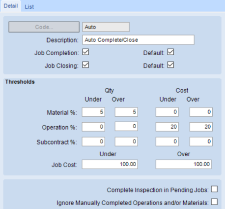

We complete/close several 100s of jobs each week and use this process so our supervisors can deal with job exceptions instead of manually review all production jobs.
We run this as a two step process. We have the Auto Completion schedule run first and then run the Auto Close process after completion is done as daily scheduled tasks.
Our thresholds are setup as shown below.
Our supervisors use the Job Closing Exception Tracker to review jobs that were not auto closed.
They can also use the Job Completion Exception Tracker to see jobs that didn’t complete. They usually just use the job closing exception tracker.
The exception trackers will show in the log details why a job didn’t auto close. From there they go to Job Closing and review job in more detail to determine if the cost or material exception is ok and will either update material or labor transactions as needed or manually close the job.
