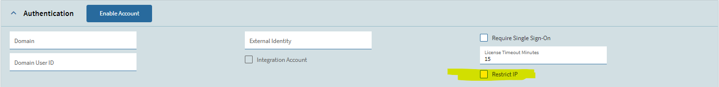

At Insights, an Epicor tech pointed out a check-box to Restrict IP -
I’ve now been told that Epicor is not allowing this function on on-premise installations.
