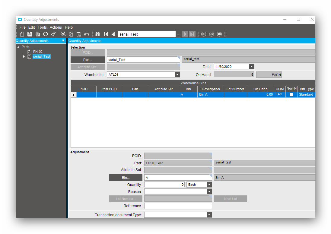

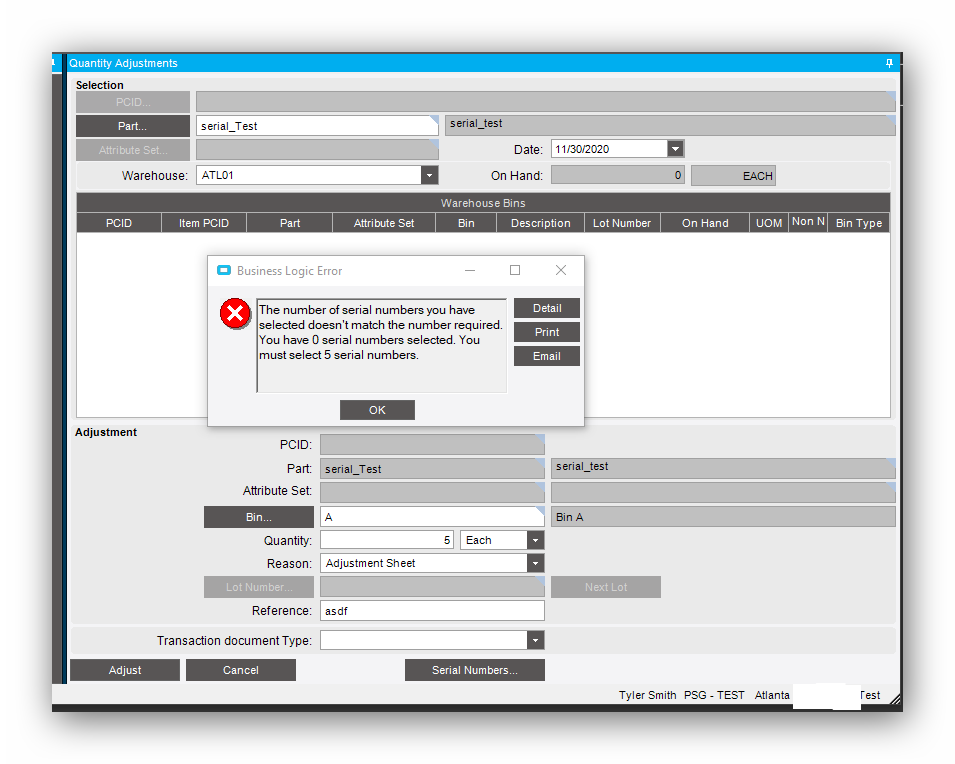

When you are in Quantity Adjustment, you will need to click the “Serial Numbers…” button at the bottom of the screen to adjust the quantity out of the system. Otherwise you get the error you saw.
Without choosing Serial Numbers:

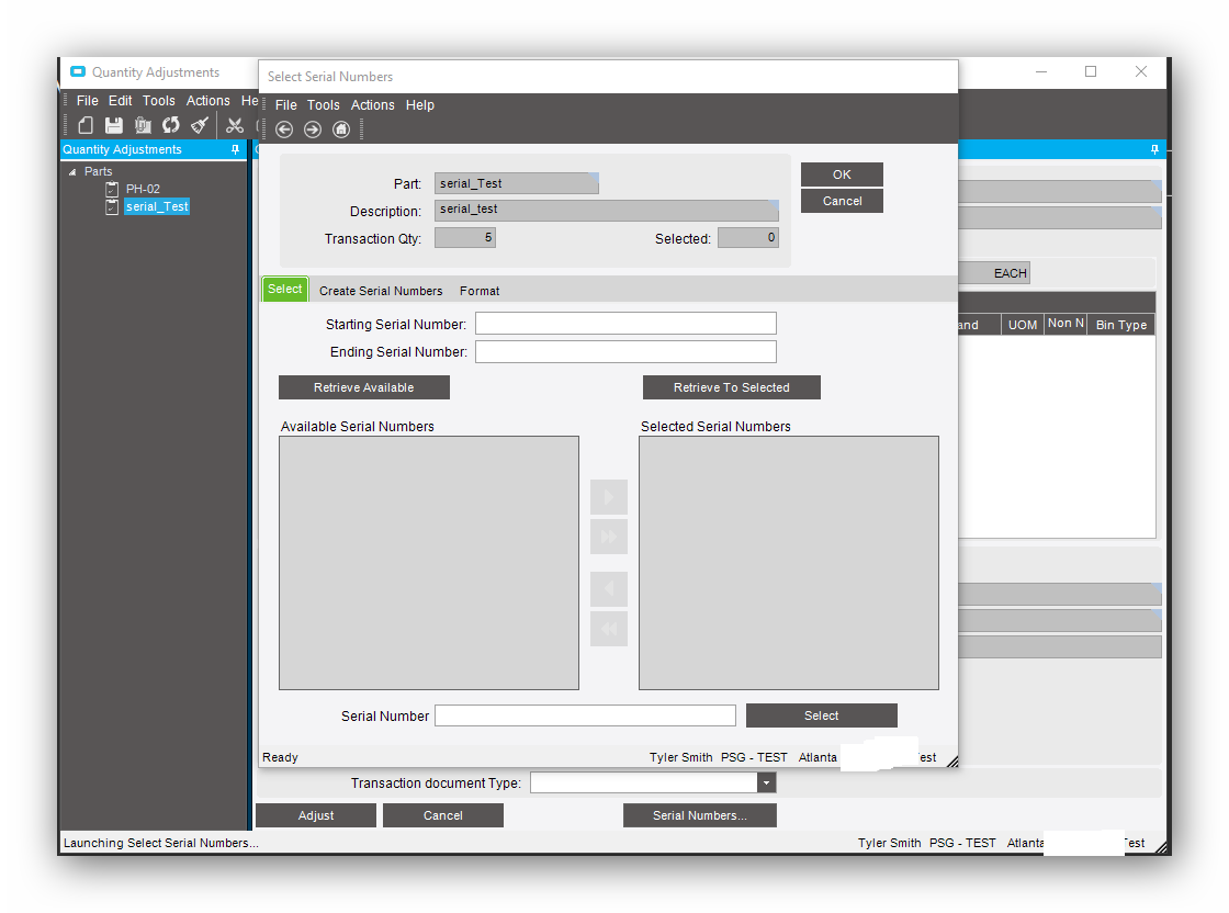

After clicking the Serial Numbers… button. If you click the “Retrieve Available” button, it will show all of the serial numbers you have in the system:

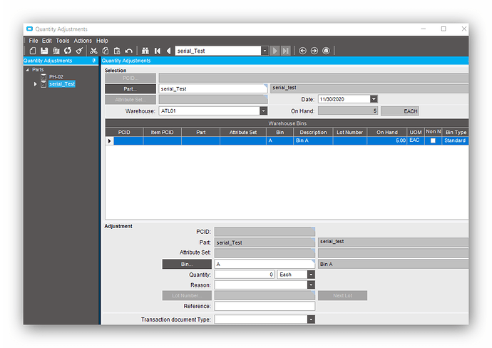

After chosing/creating serial numbers in the selection screen, Epicor now shows the 5 on hand:
