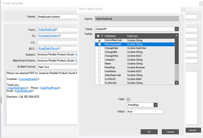

We are running 10.2.700.6 and are having trouble using the Filter feature in the email template.
we commonly have multiple sales people associated with a quote. when we print the quote we would lke the PDF to only go to the PrimRep. so we added a filter to look for PrimRep = true.
This works if there is only one salesperson on the quote. but if there are multiple people and some may not have email addresses then the email information in the email body is blank.
just wondering if anyone else has seen this issue? Any workarounds?

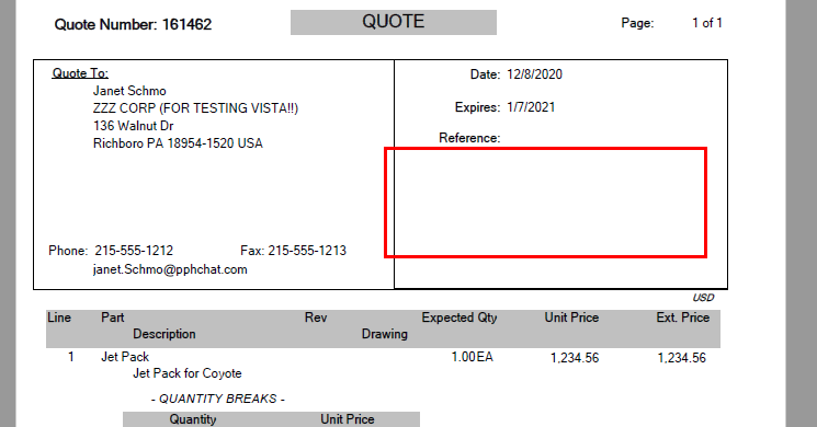

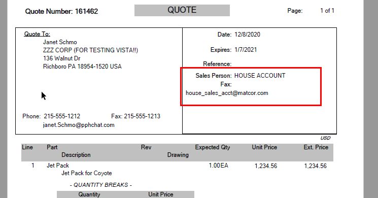

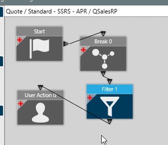

I made a test Report Style with APR (breaking on QSalesRP), with a Break widget breaking on SalesRepCode. No Filters.
A quote with 2 Sales People prints the quote twice. BUT the Salesperson Info only prints on one of them - the one with the Primary Sales Rep.
The other shows:
But all the other info (OrderDtl) shows ok.
If I make the other person the Prim Rep, than one report shows with their info and the other is blank.

Adding the Filter block:
with
And I get just the one printed - and it has the rep info.

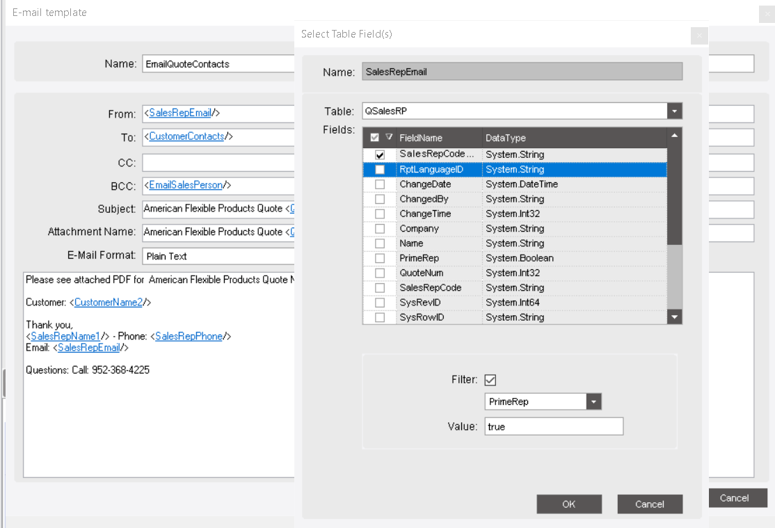

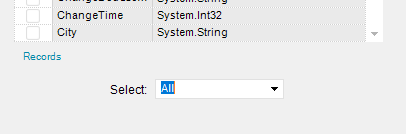

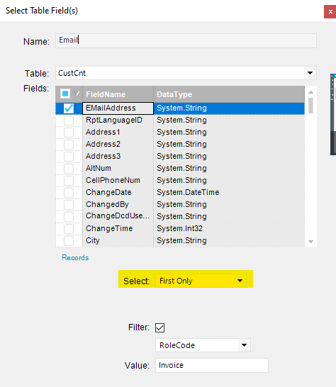

On the e-mail, when you set up the “To:” field in the template, do you have the following set?
Or did you change that to “All”?
this is the sales rep “From”
