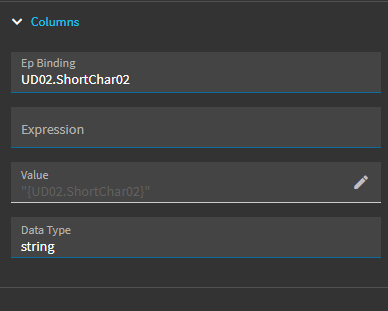

I have create a button, an event to fire on clicking the button. I try to use RowUpdate widget with the following parameters.

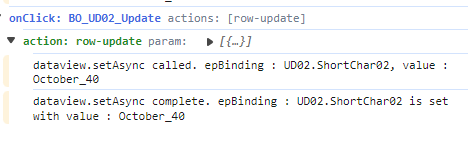

Eventhough when i check the console via msEdge (f12) i can see that value i put into a text box is being passed, it does not update the UD02 table.

In my UD forms I use and Event-Next after the Row-Update and the event parameter is OnClick_toolSave
To fire use the OnBlur under the Behaviors of the control.
Apologies, I have just followed this post Row-Update - Kinetic 202X - Epicor User Help Forum (epiusers.help) worked perfectly.

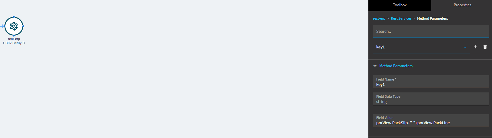

my next issue is passing key 1 as two conctenated fields. i tried porView.PackSlip+“-”+porView.PackLine but i get an error stating it is not found.
