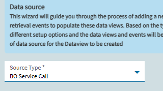

I’m playing with Application Wizard, working with UD01 from a BO service instead of a BAQ.
My aim is to see if I can maintain UD01 like the UD01 form does and add a list view, which the Kinetic UD01 form does not appear to have.

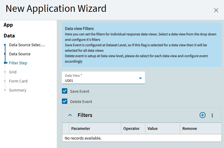

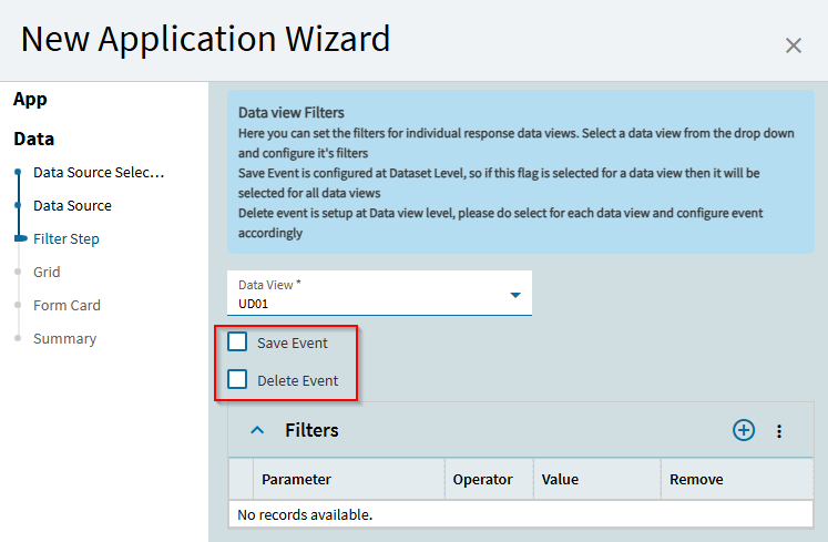

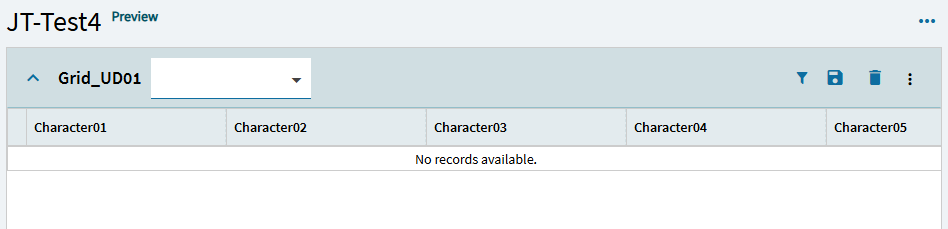

I can add a save and a delete event:
But nothing like a new record button or a new record action in the overflow menu shows up:
Am I just missing it? Is there a workaround?

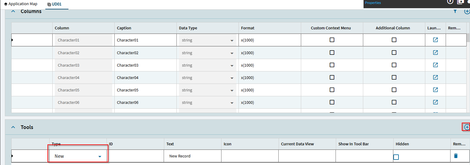

I also tried adding a tool:
No apparent effect.

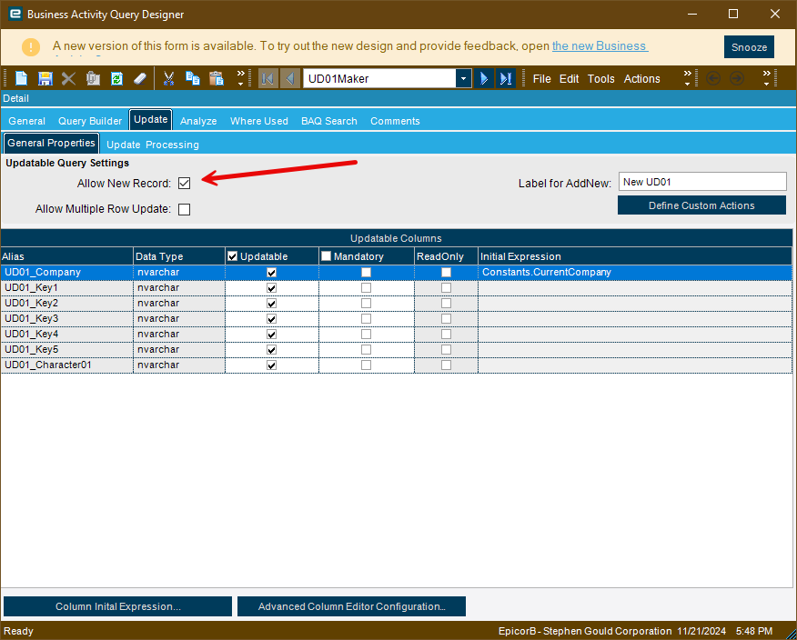

Is your BAQ SAetup correctly to allow New?
I mean in your screenshot there’s a + button right above the grid…

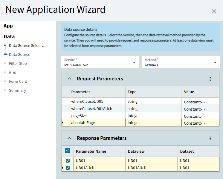

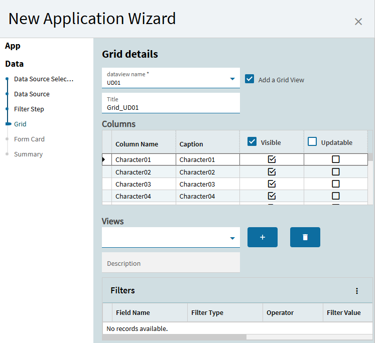

I’m not getting the view from a BAQ, but the BO service. It’s probably easier if I just show the flow:
See if that all makes sense.
Joe

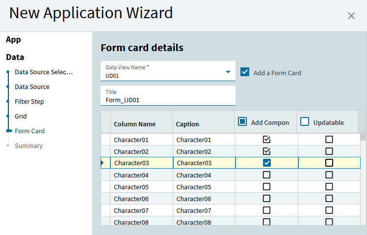

I didn’t make all the fields updatable the first time. But when I make them all updatable it didn’t seem to make a difference.

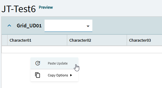

And I don’t have Paste Insert as an option:
I do get paste insert

When I choose an updatable BAQ as the data source, I do get a new record button, but then not a save button or delete option.
I can create a new record and populate Key1 and other fields and can’t save it. I would expect that if I create another new record, it would save the first, but no.
In fact, I’m unable to save a new record even with Paste New. The records show up on the screen but don’t save.
The same when I generate an updatable dashboard from Classic and test it as a Kinetic dashboard.
But it works just fine when I test as a Classic dashboard.
