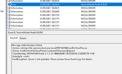

Error on the console is :
System.UnauthorizedAccessException: Server is not available. Please review Server Event Logs for details. —> System.ServiceModel.Security.MessageSecurityException: An unsecured or incorrectly secured fault was received from the other party. See the inner FaultException for the fault code and detail. —> System.ServiceModel.FaultException: Server is not available. Please review Server Event Logs for details.
Error in Epicor event log is
