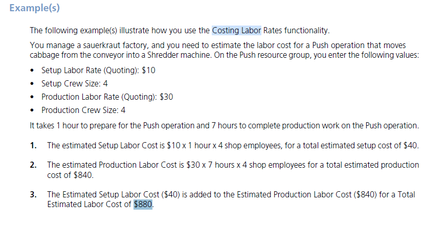

@jkane @Beth @Mark_Wonsil got any more info on how you guys do it?
Heres the thing when we run Costing Workbench Epicor is suggesting a Std Labor Rate of 30$ when it should be 1.00$ because they slap the entirety of the Setup to it. So thats why most people use Excel / DMT and not the Costing Rollup because they are confused, as we were :slight_smile: Its like we will do all this math and honor Pcs Per Hours and then just + Setup Rate * Setup Hrs :smiley:

We start with our one and only, golden :coin: MOM :coin:. Next thing to determine is the Standard Cost.
  • First thing is to determine the Costing Lot Size. This is determined based off of setup times and yields. It is determined that 25 pieces is the best lot size for the operation with the most setup time, write that down. Now, if you have material yield to factor in, you need to note that too. If the operation with the longest setup time takes 1 piece of something and yields 10 parts, that does not jive with the 25 that was determined earlier. In this case, I would set the Costing Lot Size to 30 because the “best” for spreading the setup was 25 but the input material yields multiples of 10 and you have already said you don’t want to go under 25. Done.
  • Now that you have a CLS, you can calculate the Material and Material Burden. Simple as multiplying the sum of all those costs times the CLS. (I’m also wondering if MOQs and such factor in? I’m not a costing expert, so something to have in the back of your mind). Done.
  • Now time to calculate the labor costs. How does Epicor do that? It takes the estimated times on the Operations, multiplies it times the CLS (let’s just assume the prod standard is minutes per piece), and then that is multiplied by the labor rate that is on the Resource Group/Resource. Done.
Now you can start to throw the “what ifs?” at the results. You say that you group like jobs together to save on setup? Great! Change the labor rate on setup to a 1/4 of the normal rate. Or even go to 0 if you want. Now the setup for that operation will calculate at $0 dollars.
Now quoting.
Same settings exist on the RG/Resource. Are you losing quotes due to price? Change the setup from a full rate to a lower rate. If you are happy with your win rate, keep it the same.
