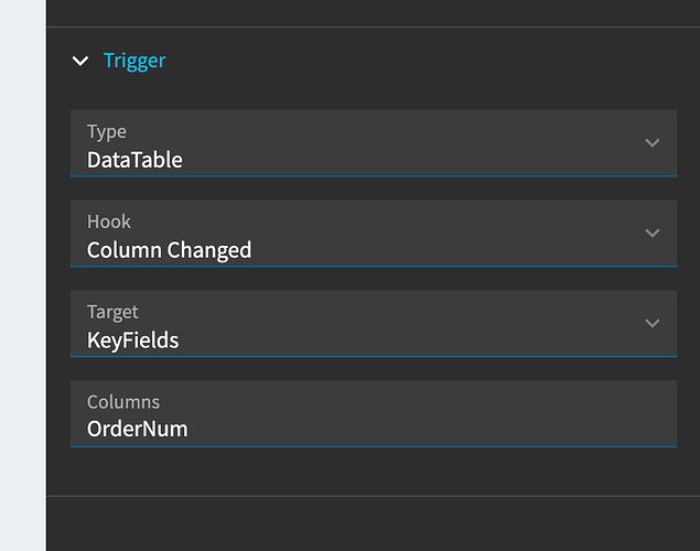

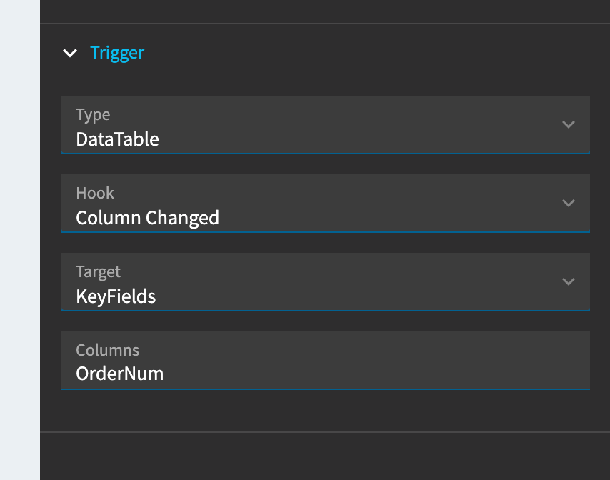

Try triggering on this:
Thanks! Works exactly how I wanted it. My dialog box popped up whenever a new Order was brought into view, even on the initial load of the first order.
