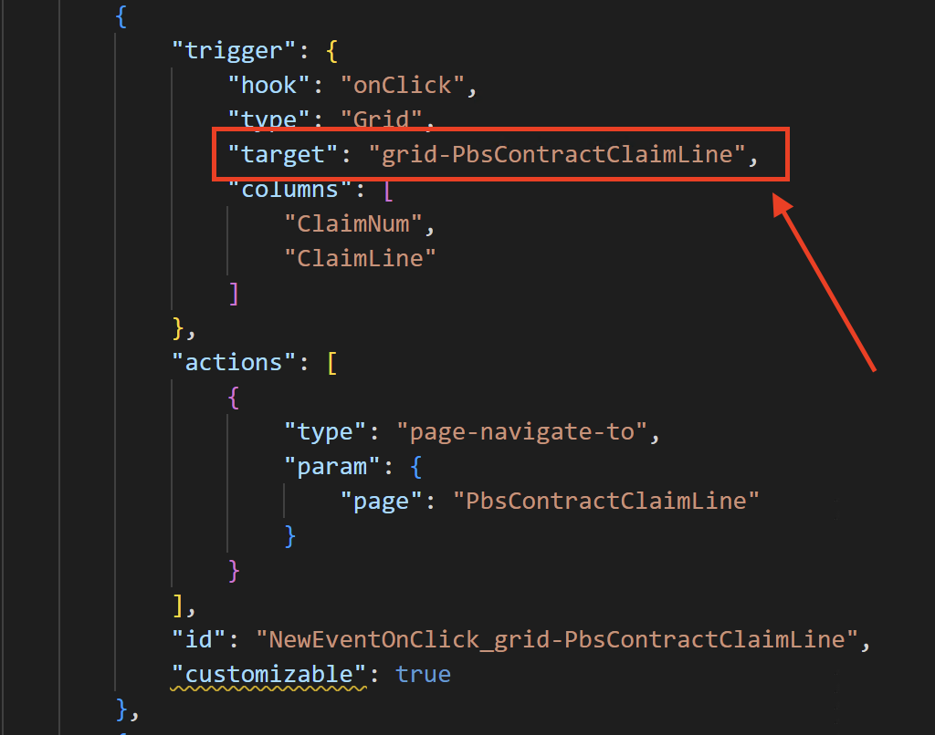

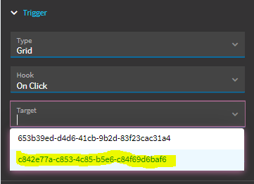

Here’s how I have my Grid On Click hook configured:
Am I misinterpreting the columns parameter?

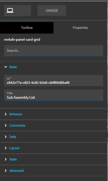

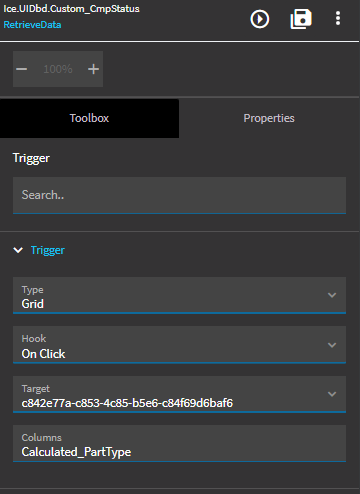

Target is the grid panel ID.
As far as I’m aware, that is the grid panel ID:
Oh–so it is. Generally they’re, well, nicer names than a Guid, lol.
Stand by.
Yeah, I noticed that. Buttons, labels, etc get a friendly name. AFAIK, grids I’ve added do not.

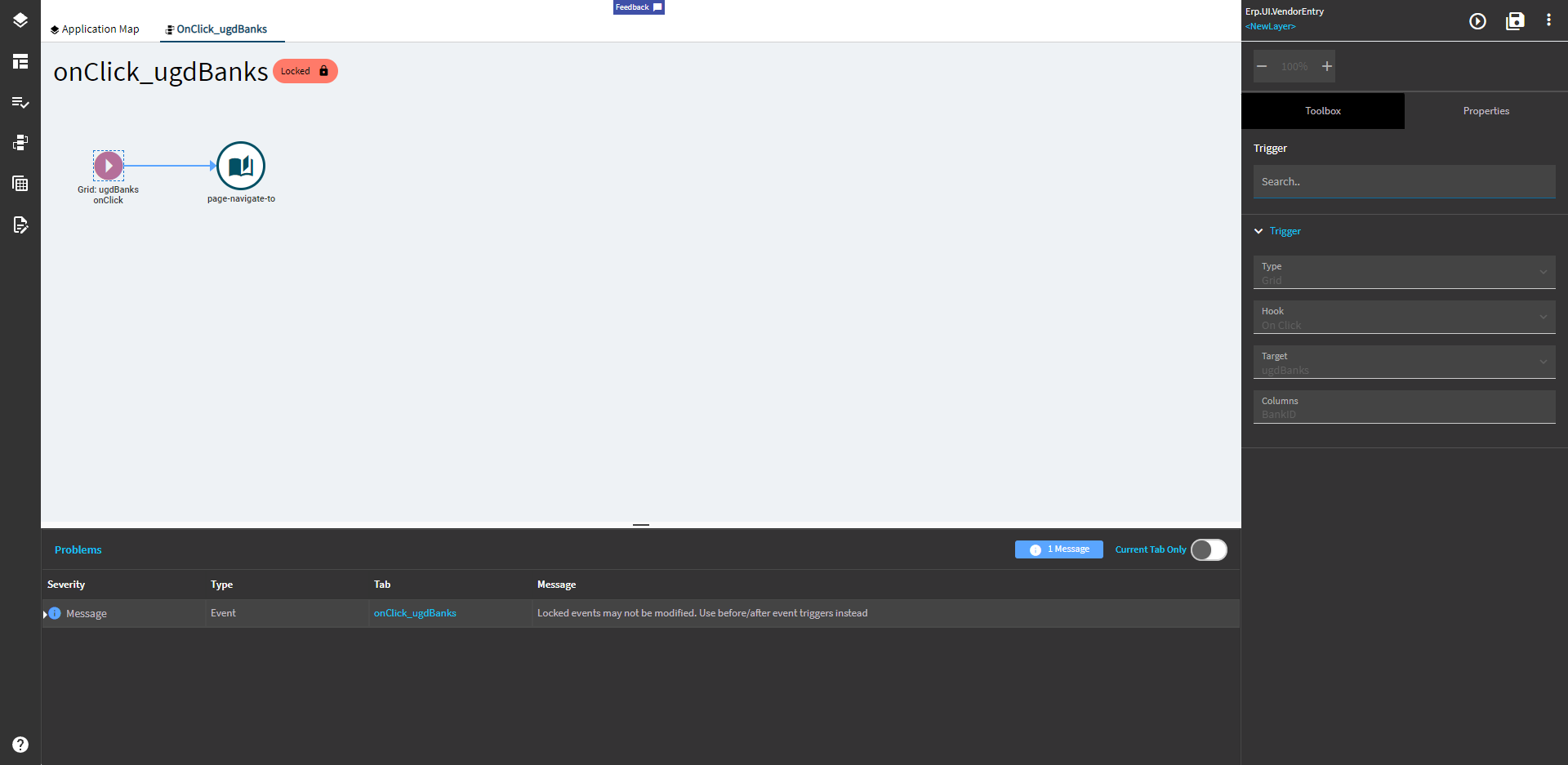

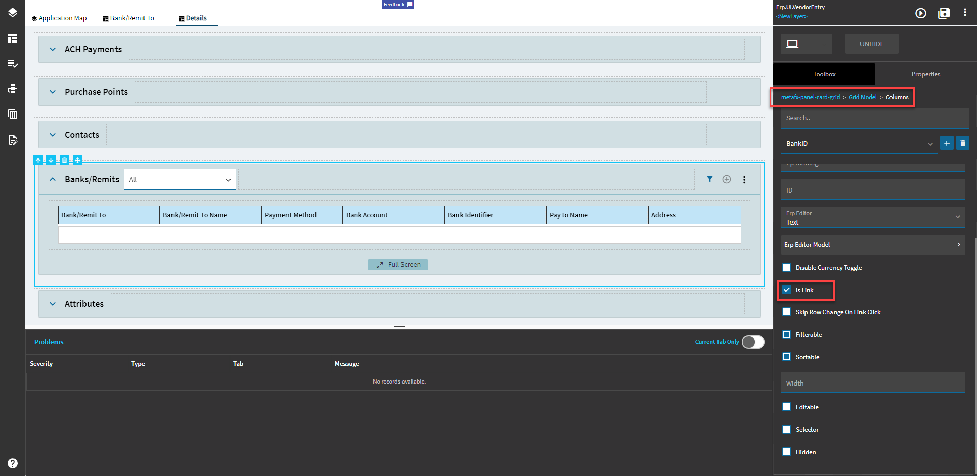

I haven’t been able to get a working example quite yet, but I did find one from Epicor in Vendor Entry.
This is how they have theirs set up:
My events don’t seem to fire when set up like theirs.

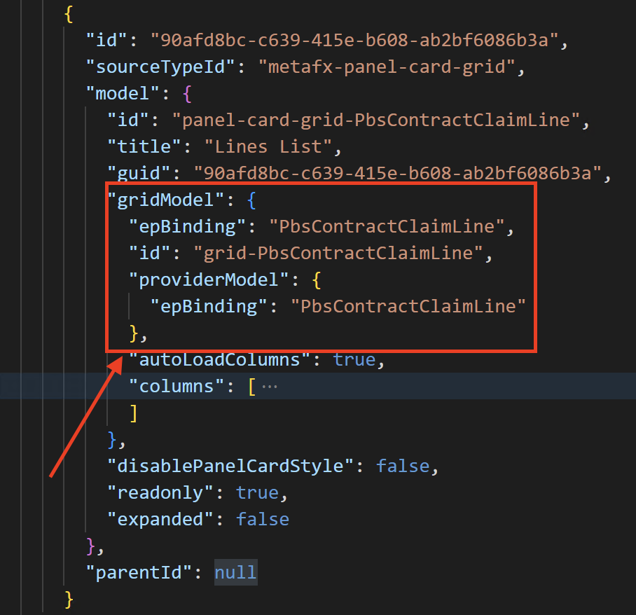

The grid On Click hook has been working for a long time now.
The requirement/trick is to setup the ID and binding properties first (they don’t default):
  • metafx-panel-card-grid > Grid Model > ID
  • metafx-panel-card-grid > Grid Model > EpBinding
  • metafx-panel-card-grid > Grid Model > Provider Model > EpBinding
Then create the event.
The output JSON/source code should then result like the following:
*.layout.jsonc
events.jsonc
It works after I checked your trick. I just got used to have database open and ready to check if everything has been saved correctly. Ough… carrying on.

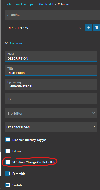

It wasn’t working for me because I must have miss-click and “Skip Row Change On Link Click” checkbox was selected
