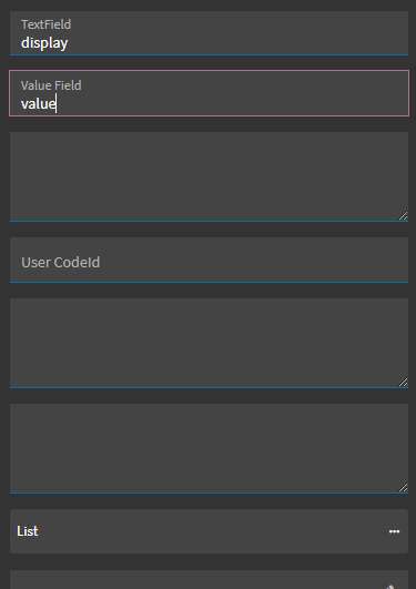

Lately I needed to do something similar. I have a combobox and its values are taken from function result. I don’t have tilde separated values but you may find that useful. I have dataview that is populating on window load. There are some topics on forum how to assign function result to dataview so I’m assuming you already know how to do it or will find it out.
In ComboBox i have set such params
  1. Reusable Combo / View Name = my view populated by function result
  2. Advanced / Drop Down Style = DropDownList
  3. Advanced / TextField = filed in the view that will be displayed
  4. Advanced / Value Field = field in the view that will provide values
  5. Advanced / Columns = Column from the view used in point 3 (Fill Field and Caption only)
  6. That’s it.
Of course if you want to use it as some relation then you should add EpBinding in Data section of that combobox. Remember that the binding will be for the value: point 4 above

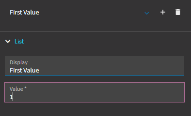

then in List, add your items:
thanks. I do know of that option. I want something that isn’t just configured. :slight_smile:
