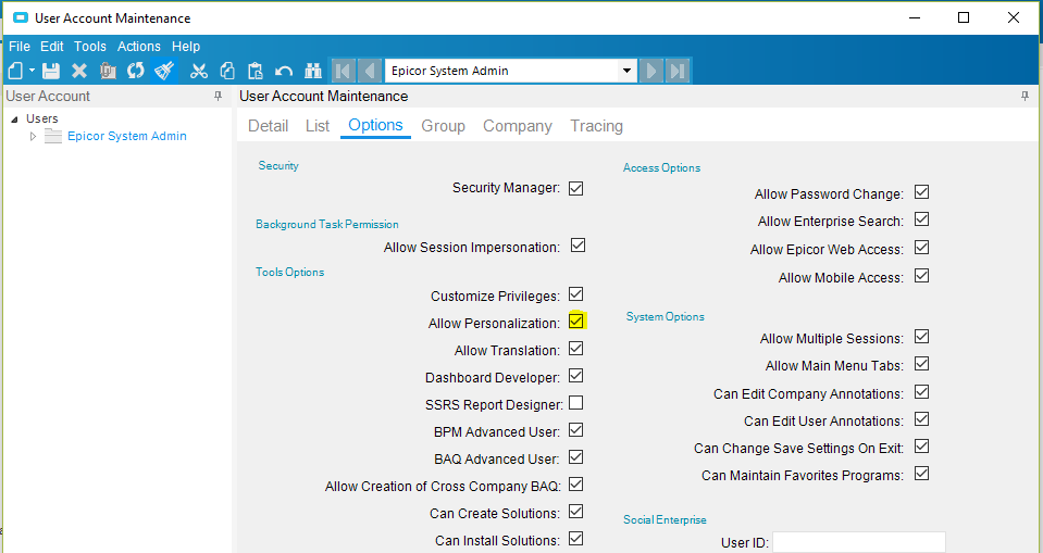

The personlization get created when you save layout(right click on screen or tool menu) or using personalization option from tool menu in every screen.
  1. delete all personalizations which you don’t want or having problem.
  2. clear client cache.
  3. disable personalization for every user as below
