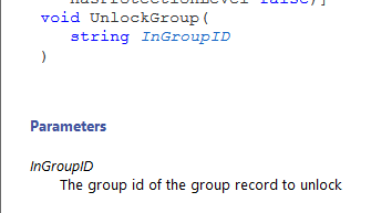

Hey Guys,
You can also call this method on the APInvGrp BO to unlock the group:
Works great!
We have this issue occasionally too. I’m thinking I should call this method on a form close event in a customization to see if it alleviates this issue
@jgehling - that’s a great idea!! We too have this problem regularly.
