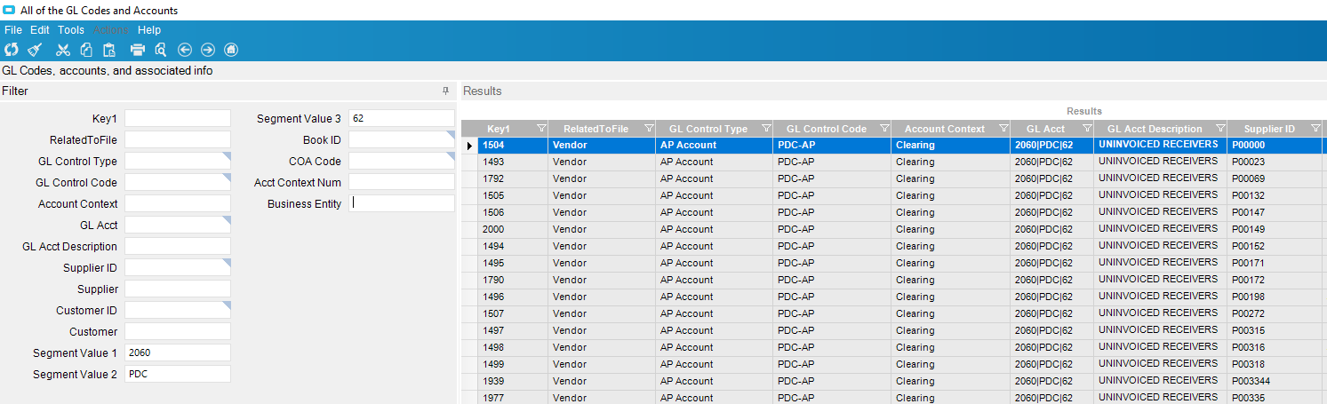

If I am trying to find EVERYTHING that hits an account, I made a dashboard that I can search:
AllTheGLCodes.dbd (204.9 KB)

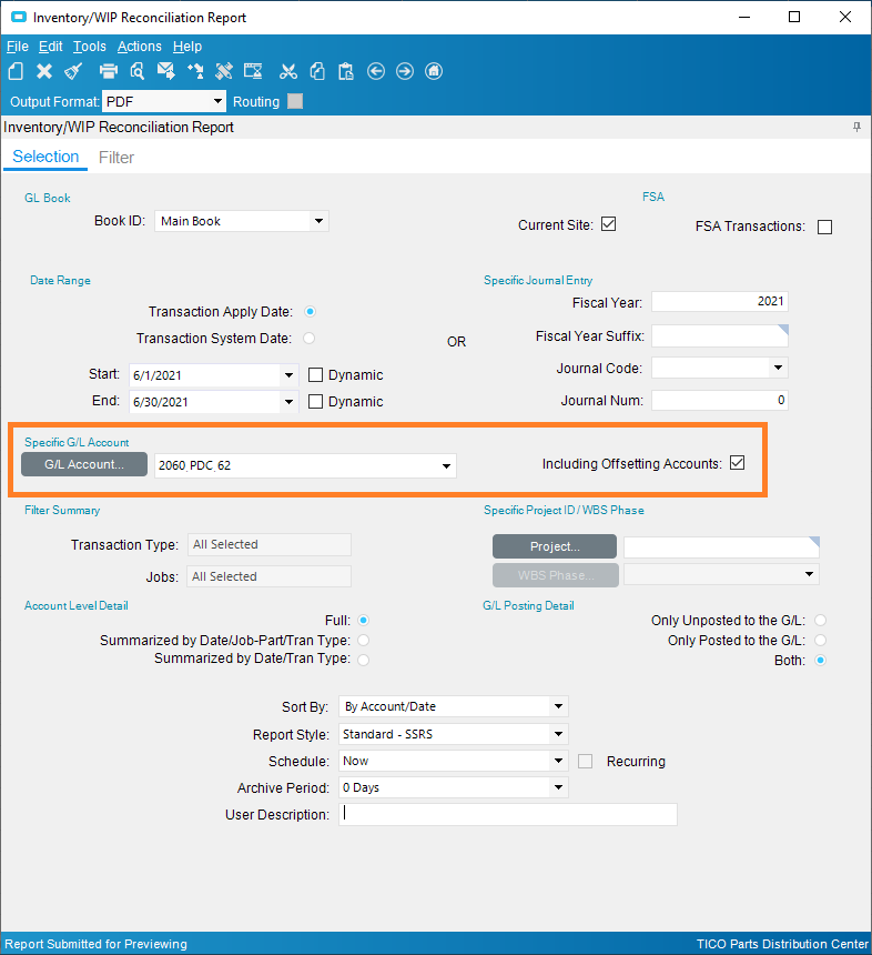

Something you might try is to pick the clearing account and then use “Including Offsetting accounts.”
