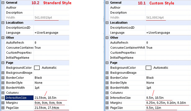

So far the only thing I’ve noticed that has changed on the STANDARD E10.2.xx AP Check.
It’s report properties are metric (cm) and all margins are zero.
While for previous versions, AP Check report properties were english (in) and margins were specified (R/L ,25 in, T/B .16 in).

Rebuilt from 10.2 STD with some trial & error to get things lining up with pre-printed checks again.
The old version seems to work on some printers that enforce a minimum margin.
i.e. failing on a BETTER printer that can go to the edges of the paper.
But… I’ve been working on it remotely so hard to verify all the details.
FWIW…a screen shot comparing the different version page properties.
