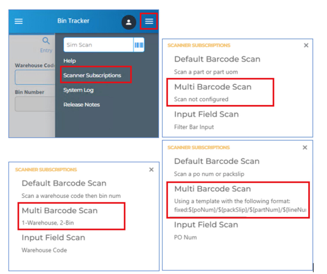

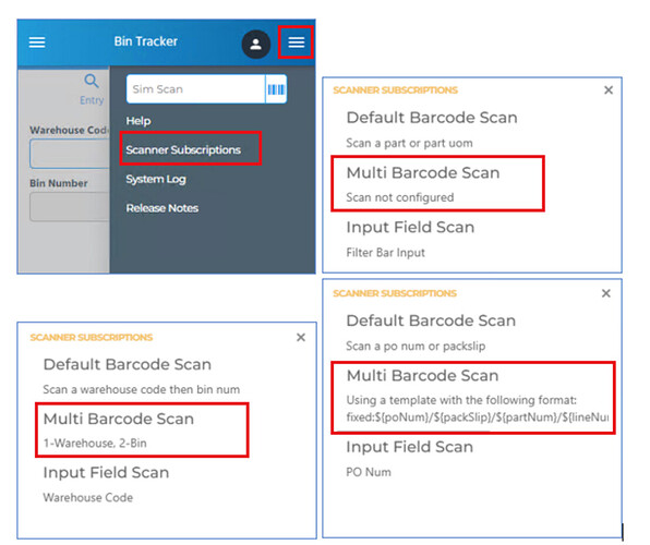

You can either create a fixed or dynamic user created template depending on the barcode, fixed will be easier to use to get to grips with the functionality and then you can expand it to a Dynamic one. You’ll need to create this in Settings > Scanner - Template and select from the dropdown PO Receipt > Receipt.
If you typed "fixed:${partNum}-${lineNum}-${relNum}-${qty}, this would work if your barcode is setup as PONUM-LINENUM-RELNUM-QTY (i.e.* 5642-1-1-250*). A separator of “-” isn’t mandatory FYI.
You can verify if your multi barcode is being used on the device
Good luck
Joe
I’m finally getting back to this…I created a simple PO Receipt Entry template with the format:
fixed:${poNum}/${packSlip}
Now, trying to create data to test scanning in Excel and it doesn’t work…(I’m concatenating 2 columns separated by a ‘/’, wrapped with asterisks…then I use the 3 of 9 font).
It scans 3030
30347,/,BS123
Any ideas or isn’t it that easy?
