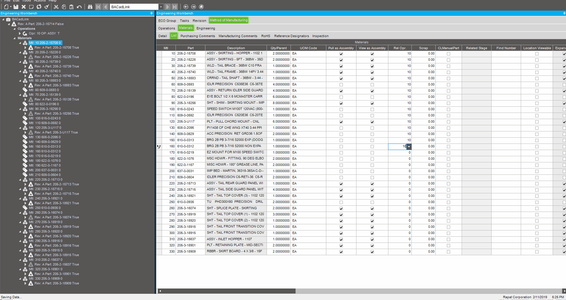

Does anyone have any idea how I can speed this up? All I am tying to do is assign the related op to 10. I don’t know what the BO is looking at, but once you get into a large assembly, it takes forever. See the gif. (yes it does change it just is reeealllly slow)
I can’t really do anything about the size of the assembly. Any ideas?

One thing I have found, when doing some testing, it to collapse the tree all of the way first before changing the ops. General use is I expand the tree, and collapse assemblies that have operations to make sure everything is done. I’m guess that this is loading the whole tree into the dataview. If I don’t expand the tree, it’s still slow, but not excruciatingly so.
