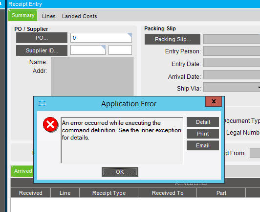

We recently updated our test environment with current data. Now I don’t seem to be able to pull PO’s into receipt entry screen. They come up in search box, but when I select, I get this error:
2
I was trying to work around it momentarily, but then I got the same error trying to use DMT on Test environment while updating Part Class field:
Has anyone encountered this error? Do I need to re-update my test environment to resolve?

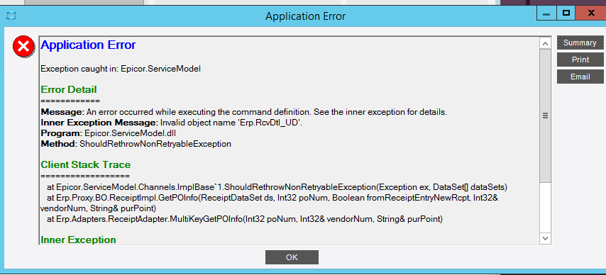

Expand the error that’s where the meat is…
So I see this has to do with a UD table on RcvDtl:
Problem is, there is currently no UD table on rcvdtl in either test or production. Prior to the refresh of TEST, someone HAD CREATED a UD field on this table but I assumed it would overide. There are no BMS on the table and I can’t find a UD field referenced on any customizations on Receipt.
6
Your Data Model is out of Sync. Re-Gen Data Model, Recycle App server.
