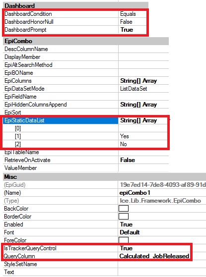

I have found that when you want to filter by a boolean value, (True, False, or “either one”) it is easiest to create a calculated field in the BAQ that is TEXT with the words “True” and “False” or “Yes”, “No”… THEN in the dashboard filter on that text field. You can create a COMBO box that has the two values… if you leave the combo blank, then it doesn’t filter at all. This way, I can have the dashboard ask “Firm Jobs?” with the combo… and if they choose “Yes” it only shows firm jobs, “No” does not show firm jobs, and blank shows ALL jobs.
They don’t work in a dashboard tracker. Only in customizations.
Thank you Tim, it sounds easier compared to what I was planning to do. Is “blank” an option on the dropdown, or something the user needs to clear to search for both Yes/No?
I’m fairly new to Dashboards, could you take a look on my setup? The ones in red are the fields I set. I’m curious if I missed something.
Thanks Again.
I use the textbox method with a calculated “YNB” field. And you don’t have enter the wildcard characters.
Just use the “Matches” condition on the dashboard’s tracker.
And as a bonus, you don’t even have to enter “B” for both. Because a blank value means to ignore the condition altogether.
blank “Inactive” tracker field results in both “YB” and “NB” results
I tried that first. For some reason I couldn’t make it work without the Wildcard. I imported the Dashboard you are showing in the pictures from a different Post from you, and I needed the wildcard as well. Thanks for Sharing.
