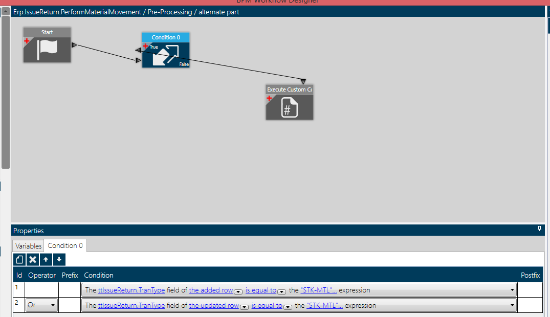

I have also faced this condition before, and i have written a BPM for restrict unwanted PartNum issue, other than BOM part or its alternate part.
I am sharing its BPM, please write the code after creating a condition (as in picture).
BO- IssueReturn
Method -PerformMaterialMovement
Condition (STK-MTL) is for selecting only -Issue material to job.
Copy and paste the code in C# code window.
Good Luck !
code.txt (745 Bytes)

I had to make a few tweaks and will have to test some more, but in general it is about 95% where I need it to be.
For instance the ttt and ps1 had to be declared. I am also seeing about the instance where the Part is not on the BOM and the part attempting to issue is not a substitute part in the DB it throws a BPM error not the BusinessObjectMessage.
