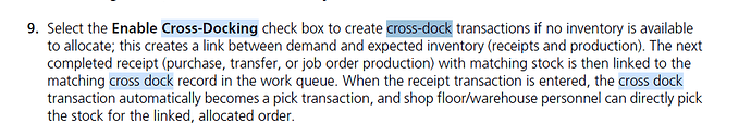

I believe that’s what the “Cross Dock” function is for. I’ve personally never used it but heard about it at one point.

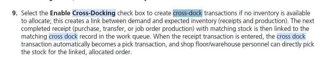

Here’s a screenshot from the 10.2.7 Application Guide

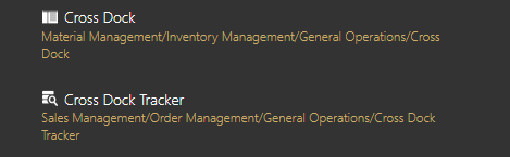

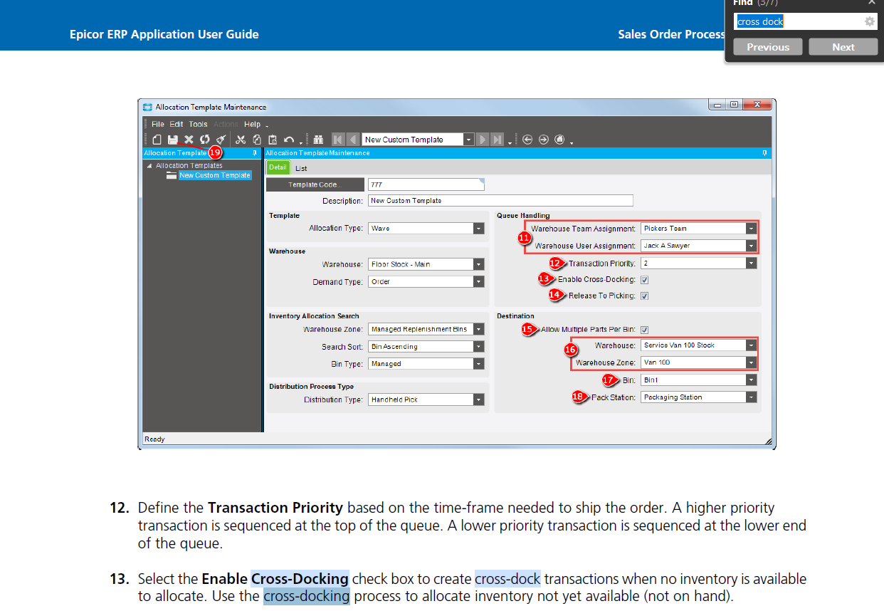

@Fernando @Sam_Bise That is what cross docking does. One thing we have to watch for is that it reacts to every receipt to inventory and makes a material queue record, so if you have a job of 100 and they are going thru inspection in groups of 10 to be placed in inventory it will make 10 entries.
