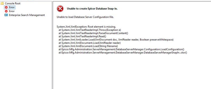

Unable to print reports due to the below error. All the reports stuck in schedule task.
Admin console:
Please help :slight_smile:
For the first error, go to server Event viewer and check logs, there will be additional error info.
Did you find a solution to this one? Do you need to reinstall the administration console?
Hi Joe,
I reinstall the task agent service. Followed by,
  • Cleared the cache directory
  • Restart the task agent service
  • issue resolved
