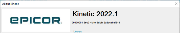

the issue is bigger than that and appears to be due to any diversion from the stock security groups which is necessary if you have some users on kinetic and some not as we do. This is a major bug which breaks the shortcut icons, you will find all forms work fine if you access from the tree just not from the desktop icons. if you get an access denied simply refreshing the page lets you in as it should. there is something fundamentally wrong with the security on the home screen icons. BTW i am on the latest 2022 release to fix an even bigger security mess in 2021. I will be reporting to Epicor first thing in the morning.
