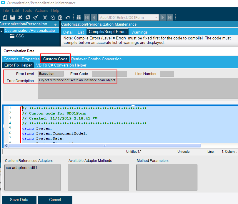

After Epicor version upgrade to 10.2.600.2. Facing error in the customization which was done in the version 10.2.500.12
We created the customization in MES for capturing data from the operators in the Epicor version 10.2.500.12. Recently the version got upgrade to 10.2.600.2. When I ran - verify customization in Customization maintenance. I am getting this error in newer version. Kindly help me.

Aaron, here is the screenshot, but I do not know how to fix this.
Aaron, when you find time today, can you please guide me for this object reference issue.

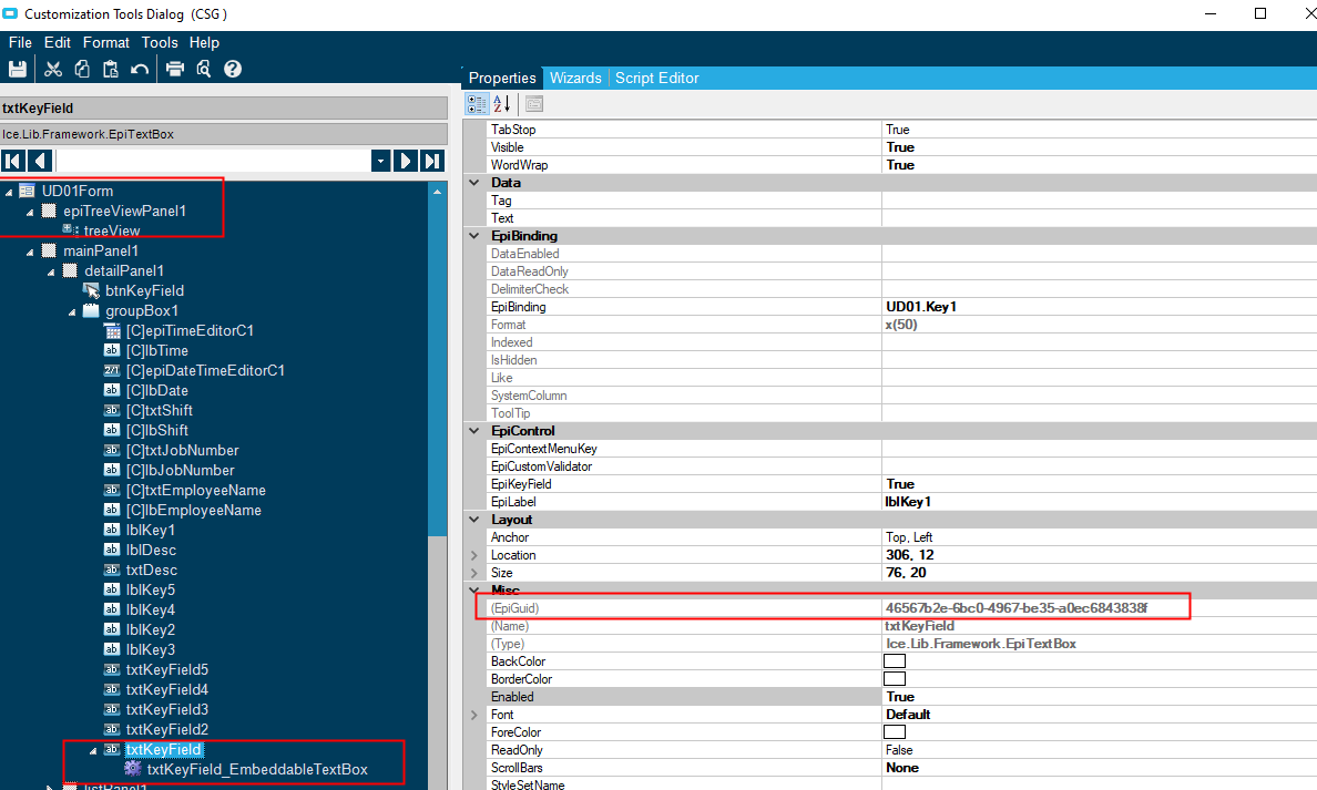

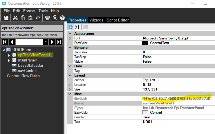

Aaron means the base form control references or Ids, these:
treeView = (EpiTreeViewPanel)csm.GetNativeControlReference(“ff47e708-60d7-4586-9708-91a5d57fb7a6”);
txt1 = (Ice.Lib.Framework.EpiTextBox)this.csm.GetNativeControlReference(“46567b2e-6bc0-4967-be35-a0ec6843838f”);
I can see that “46567b2e-6bc0-4967-be35-a0ec6843838f” is the id for the txtSalesRepCode control, however the MES screen doesn’t have a treeview in either 10.2.500 or 10.2.600.
Is the treeview part of the UD01 Form?
You need to review what you are trying to do with the treeView and “ff47e708-60d7-4586-9708-91a5d57fb7a6” seems to be an invalid value.
Jonathan,
Yes the treeview is a part of the UD01 form
So it is the other way around, “46567b2e-6bc0-4967-be35-a0ec6843838f” is part of the MES form and not the UD01 Form so it shoulnd’t be there.
And also if you look at the code you are not using txt1, I’m guessing it is there from a copied customization.
Jonathan,
Both treeview and txt1 are part of UD01 Form.
