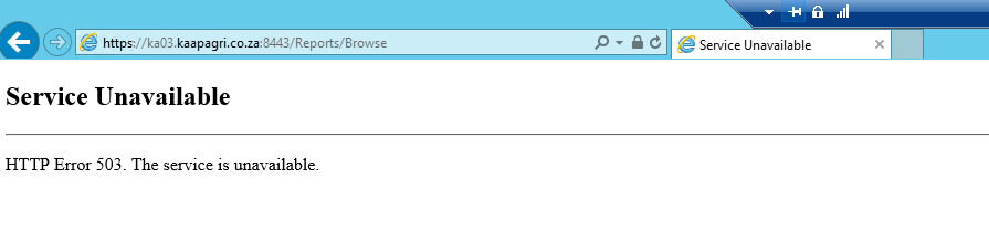

I am battling with the AFR Viewer at one of our customer sites and hope someone may be able to assist.
I have logged this with Epicor but so far 1st line support could not find the problem.
When I browse to the AFR Viewer URL I get a message that the service is not available. This worked though for a while until an update was loaded on the server where AFR is installed and the server was restarted. The ID of the server changed so I had to get a new license. I am not able to get into the Designer and run reports but the Viewer will not work again.

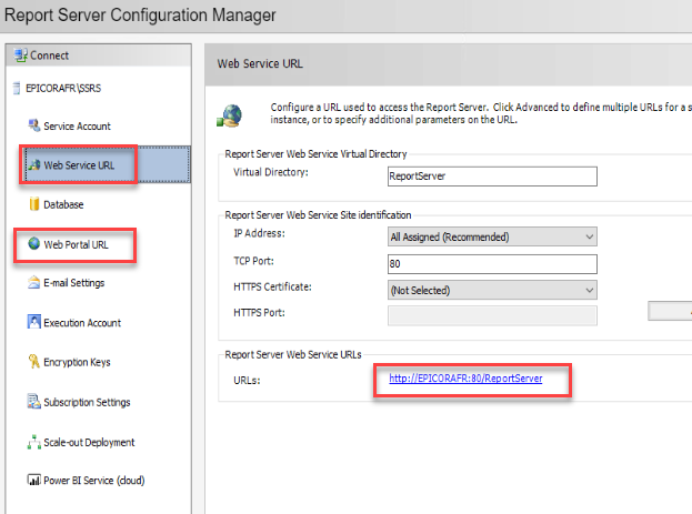

We have checked the AFR Server URL, SSRS Reports URL, SSRS ReportServer URL which all work. We also double checked the certificate for the AFR Web Site and Service.

Given what you’ve said so far, I’m going to say that your Https/Http urls are crossed up somewhere. I recalled having a similar issue when we upgraded about 6 months ago and thought it might have been the service, but now I’m thinking that it’s https. Something about SSRS Configuration/URLs and SSL certs… We couldn’t get HTTPS to work, so we’re still using regular HTTP. But check the areas below and make sure certs/urls/etc. are correct and that you are actually connecting to the correct URL.
We also not using HTTPS for SSRS so there is no SSL cert requirement that end. However I did add HTTPS to SSRS yesterday to test but still no luck. What did happen though is that when I had added the HTTPS protocol and I browsed to https://ssrs_server/reports it gave me the same “Service Unavailable” error. I had to restart the SSRS service then it worked.
So I am wondering that when AFR is trying to redirect/call the SSRS portal/api there is an issue. But I cannot determine what though and I cannot find any error messages to assist either.
I also changed the accounts for the AFR app pools to “AppPoolIdentity” and the SSRS service to “Virtual Service Account” as suggested by Epicor support but this did not work.
After a long evening of trying to remember, here is what I remember. This version uses a method where the installation alters the regular SSRS security by inserting a DLL to ‘handle’ all the requests for reports within the AFR report folders. This is now the ‘license’ server as we remember it. So there is no passing of requests between AFR and SSRS any longer - at least none that we can control. All connections are made through the SSRS url and as long as you are using the correct one, this should work fine.
Other data for you to ponder I may have misquoted earlier regarding SSL/certs as I was looking only at our SSRS config utlitiy.

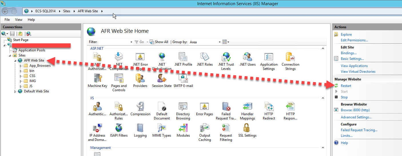

IIS
Our app pools run with a AD domain user with ‘admin’ level privs called ‘epicorservice’. This makes sure that all access is granted to that user and that all inter-app communications works (and is controllable/stoppable) at the domain level instead o the OS/Service level.
This user also has high level access to both the AFR and Epicor SQL servers/databases.
We have a proper SSL cert (wildcard issued) from DigiCert installed in IIS at the server level.
Both our ARF Service and AFR WebSite IIS Sites use the 443 binding with the above SSL cert.
