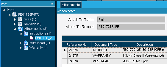

@asmar - Have you had any luck? We’d like to print our part instructions automatically with our pack slip, but do not have DocStar either. I’m surprised that we’d have to buy yet another module to do it! We already purchased APR…
I have not found any code-based solution. We are waiting on management to approve the purchase of DocStar.
if it makes you feel any better about it, attaching the documents is simple once you have them in docstar.
Make sure your team is attaching documents with a document type in epicor, the attachments in routing are much cleaner this way.
