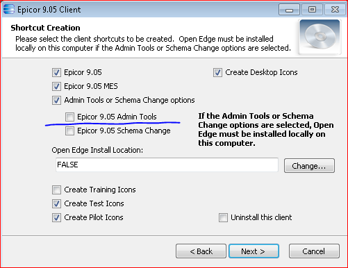

An admin workstation is the same as a local machine, if you follow those instructions you can install Admin on your local machine. If you follow those exact instructions in your local machine you’ll have admin tools and such in your machine.
Run the client install.
Check the Admin Tools or Schema Change Options to reveal those options.
Set the folder where your OE is. Check the box Admin Tools.
You may have to uninstall first.
