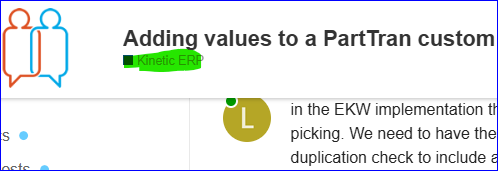

(Note: I selected Kinetic ERP in the dropdown, but the post seems to show 10.x. We are in the cloud at 2024.2.x)
While I don’t have any huge input on your actual question aside from the fact we generally brough in historical records via UD tables. But hopefully someone else will be able to provide help there.
The Kinetic ERP option you chose shows up in the top ribbon:

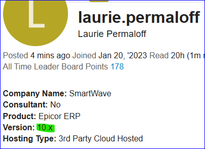

The “10.x” is coming from your user profile:
You can update that anytime you want if you click on your user icon in the upper right. Then choose the little user icon,
then preferences… then profile.
Down below you’ll see a “Version” text box you can update any time you want.
