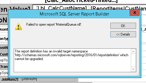

Hello All - I followed the instructions on how to add a table to an existing dataset using Report Data Definition and Report Style, however, I hit a bump when trying to to open the report in SSRS.
I’m really at a loss as to what to do next. Does anyone have any thoughts?

Odd, since the 2016 in the error message makes it look like it was used by a more recent version of Report Builder… :thinking:

According to Epicor instructions, I am supposed to go the downloaded new version in explorer, open that, and add the new field(s). However, doing that opens a funky looking version of SSRS. In that version I was able to add the new field by resetting the expression for part description to line description.
Using this method, the new report version isn’t what prints out of Epicor. So - I thought I could open SSRS, open my dowloaded version and change in what appears to be the correct ssrs environment, but that throws the error shown above.
Oh no. That’s only for BAQ Reports. Unfortunately, that will hose your report. You will probably have to start over with a new download.
Once you’ve downloaded it again, open it directly with the proper Report Builder and you should be back in business. You might have two versions of RB and once the other one opened it, it converted it. :frowning:
