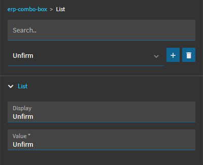

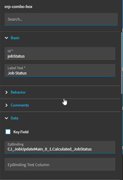

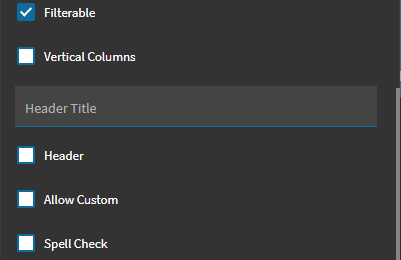

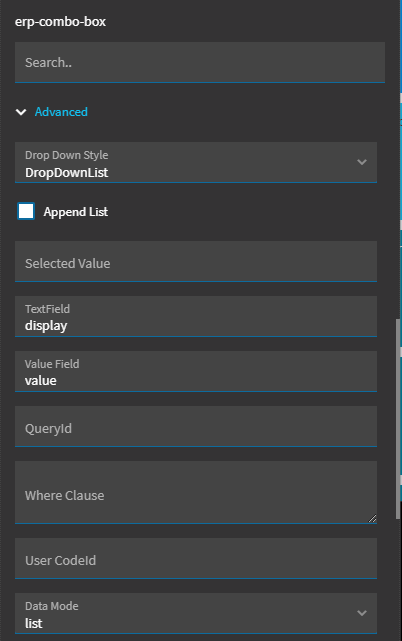

I’ve deployed a dashboard into a Kinetic version in 10.2.13 and added a dropdown list combobox to the tracker.
It displays the list correctly, but it doesn’t filter and the “Reset Search” button doesn’t clear the added field. the other fields that came from the dashboard work okay.
I’ve added screenshots of the setup below. I suspect I’m missing some little something. :slight_smile:
Ideas on the issue?
Joe
The original classic view dashboard contained a custom combobox, which didn’t make the trip to Kinetic. Evidently, neither did the column it was bound to.
I made a fresh copy of the dashboard and tracker, including the textbox created in the tracker creation. After converting to the Kinetic app, I added the dropdown box in Application Studio and hid the textbox. It seems to be happy now.
