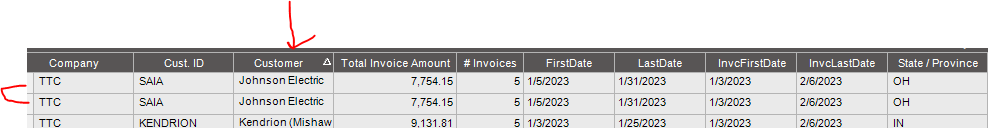

Thank you Kevin, That worked but i am getting many duplicate rows. What am i doing wrong. Duplicate rows seem to happen to me a lot when i try to create a dashboard.
Any suggestions?
Tanya
here is a screen shot
If there weren’t duplicate rows before, you can move the second customer table down to a subquery.
Only add customer1 company, custid, and state to it
then link that instead
