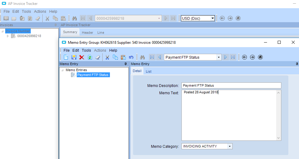

How about making a Memo entry? That’s pretty safe and can be done after payment. You can create a Memo Category for FTP Transmission and then post the info in the Description and/or Text. This field is available from A/P Invoice Tracker too. (The “Post It” Note icon).

I do like the idea of a Memo entry. Safe and accessible. Thanks, Mark!
