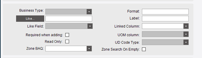

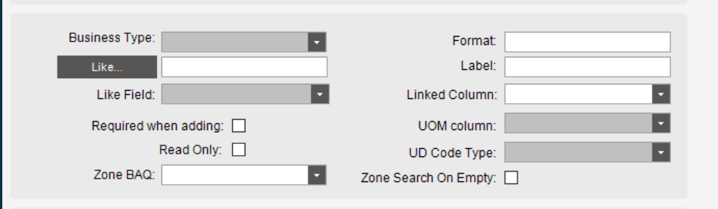

I was told that this is done by going into the UD Column Maintenance and adding them as UD fields to a UD table then request for the database regeneration process to take place. I am lost on how to approach this. I have done some research and am wondering if I create a table e.g AC_SegAccom_UD then add those columns into the AC_SegAccom_UD table then go to the below in extended property maintenance:
And add into the like section the original AC_SegAccom table and linked column, save it then request the regeneration process?
