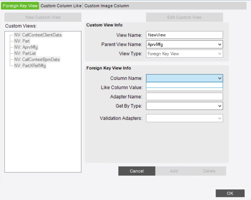

I am trying to bind a textbox on the Qualified Manufacturer Maintenance screen to a UD field created on the Manufacturer table. As far as my research has shown, there is no documentation that describes such a procedure.
Surely it is not impossible to make a new table show up in the EpiBinding dropdown?

The link I am trying to make is on AprvMfg.MfgNum == Manufacturer.MfgNum.
Is this not the correct screen to create a child view? I selected AprvMfg as the parent view because it has the MfgNum I need to make the link, but there are no options to select in the “Column Name” dropdown.
The only Parent Views that I can select that populate that dropdown are PartList and PartXRefMfg. PartXRefMfg also has the MfgNum field on its table, but only PartNum appears in the dropdown.
