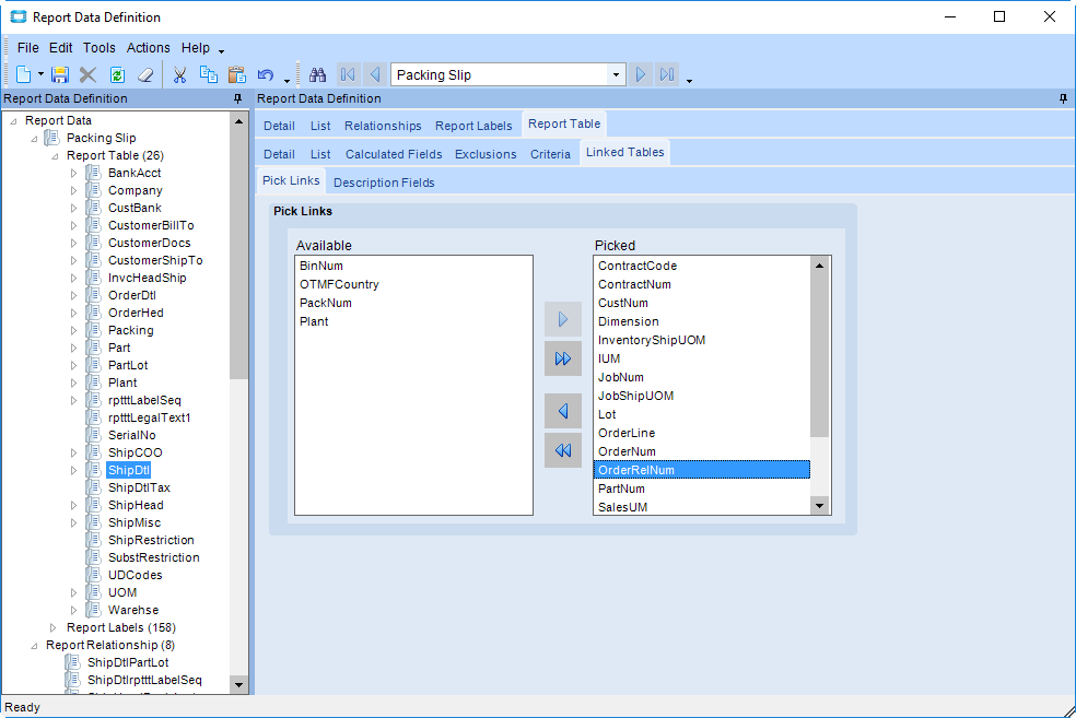

OrderRel fields are available through Linked Tables from the ShipDtl table.
Select the fields you want to display, then add the fields to Dataset Query instead of add the OrderRel table and Relationship to the RDD.
ah ha! that is it. You are great. I noticed the Dataset query calling “T2.OrderNum_PONum”, and I did not understand. Now it makes complete sense, way simpler than what I was trying to do! Thank you so much for your help!
