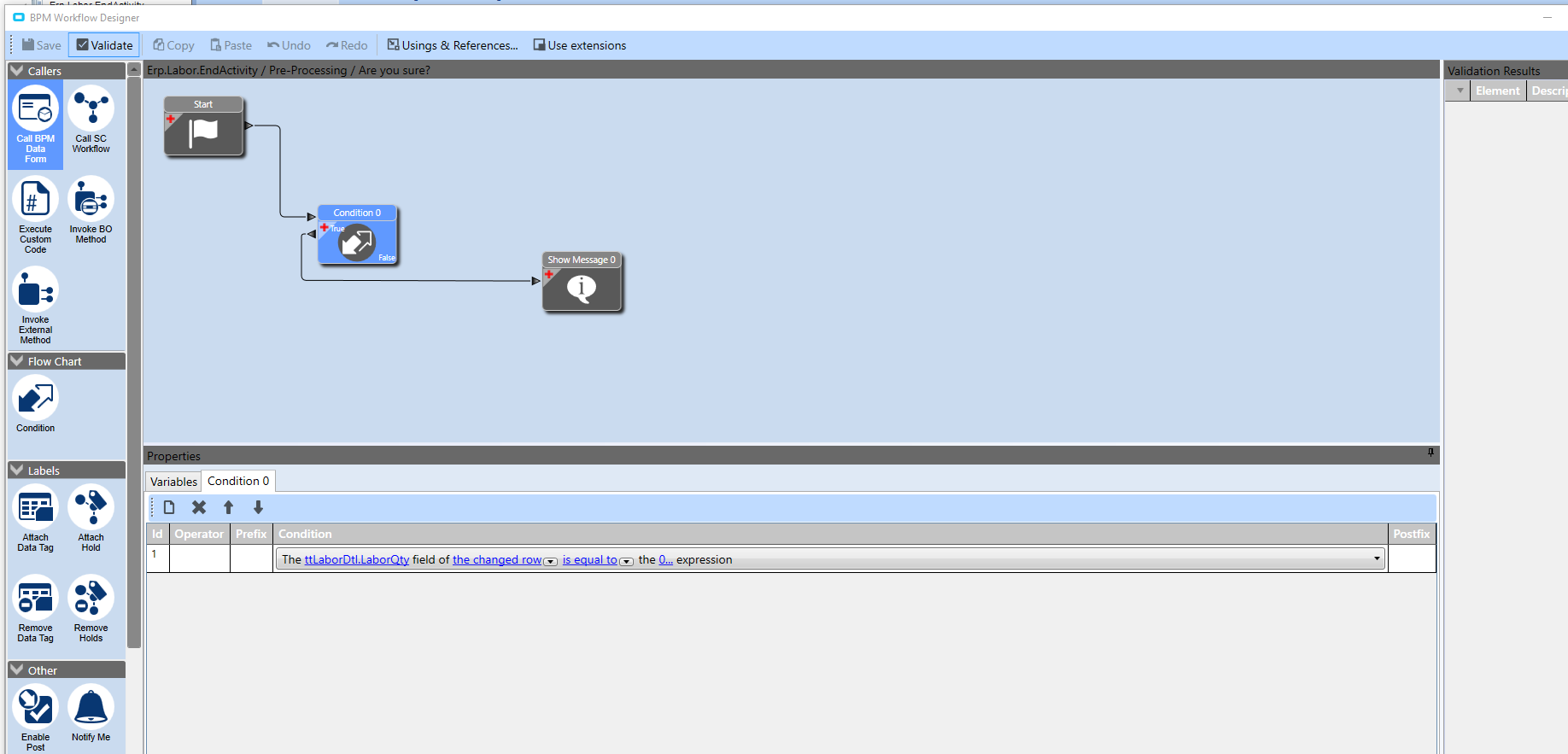

I am trying to add a pop up for when an employee ends activity and enters a labor quantity of zero. The goal is to have them question if they really didn’t run any parts.
In my mind, the directive should be Post-Processing. But, when I go to test, the message pops up when I click on the End Activity button in MES. I was hoping there was a way to have the message pop up when the employee clicks OK to end their activity. I tried Base Processing, but that just greyed out the labor quantity field and produced an error.

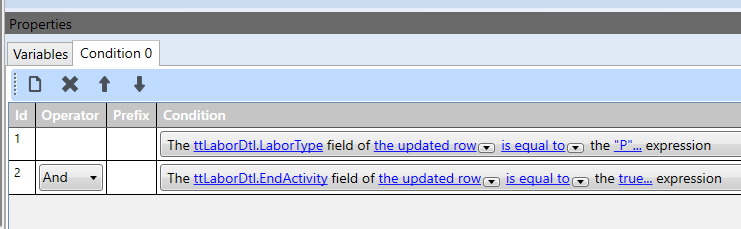

You want Labor.Update pre-processing. Create an initial condition where LaborType is P and the row is updated, and EndActivity is true.
If you report qty under setup then skip the LaborType condition but that would be weird.

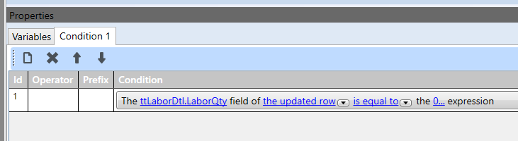

I’m new to this so bear with me… I set up these 2 conditions and I’m still getting the pop up when end activity is clicked. My table is Labor.Update.
A BPM will only fire when action is taken. You just want to capture that event and give them options before allowing the save to continue. If you want to ask them to enter a value or leave it 0, but just double check with them what their intent is you will need to use a BPM form for that.
