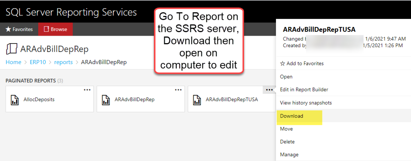

Hi Melissa,
I like to also work like Michael suggests, messing around with the query. Using SSRS I have found it useful to look at and mess around with the query in SQL server mgmt studio, if you have access. Using a test database is never a bad idea there too. I haven’t worked on SSRS reports in a bit, but here’s some notes that I made for myself to help me do it again someday. Perhaps they’ll be helpful to you.
Nancy
