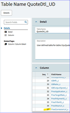

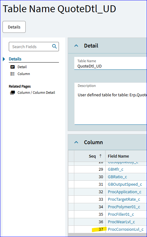

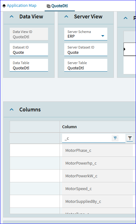

Here’s an example of simply adding UD Columns to an existing table. As @Mark_Wonsil and I mentioned, this is a much more straight-forward approach.
In this case, I added 35 UD columns to the QuoteDtl table (There are always two system columns added for SysRevID and ForeignSysRowID… that’s why the count is 37 highlighted below).
In Order Entry (or any other form where QuoteDtl is utilized), I can see all of those UD columns are included in the QuoteDtl dataview. There’s no reason to map things manually. They’re pulled in and ready to use automatically.

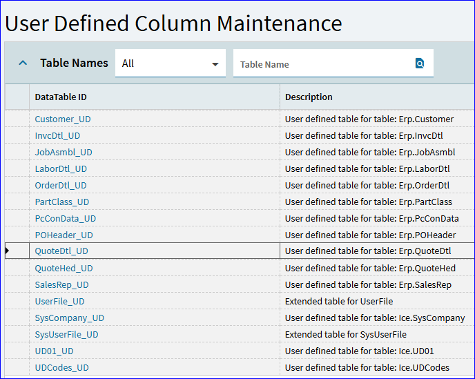

In UD Column Maintenance, you can add columns to that table. When you do this, the system creates a Part_UD “extension” table. They are automatically linked together.
Below are a bunch I’ve created in this manner:
You then add columns/fields to those tables… and they’re automatically available anywhere you use the Part table (Part_UD automatically comes along for the ride).

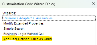

Are you looking for the Kinetic equivalent of this?

First, I recommend reviewing an existing “Idea” to bring this Wizard back into Application Studio with full functionality. Wizard - Add User Defined Table As Child
Read the comments on that “Idea” as they give a good background comparison between Classic/App Studio and what is missing that you need to set up.
VOTE FOR THE IDEA. Its been out there since July of 2023 and this needs to be pushed to get more traction. This is functionality that used to be easy in Classic but is a struggle in Application Studio, and that needs to be remedied!

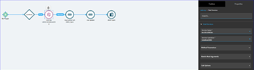

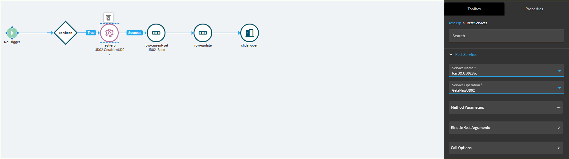

2. You’ll need an event like below to perform a rest call to GetaNewUD14:
The Trigger can be whatever you need based on your requirements. I’m calling mine from a different event, so mine is empty.
I have a condition which checks that PartNum is != “”

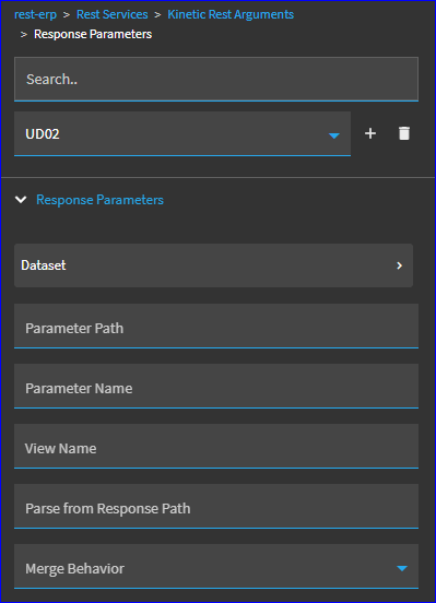

My rest-call method parameters:
I don’t have any Request Parameters…
Response Parameter:
Dataset:

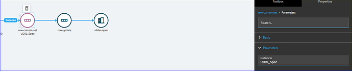

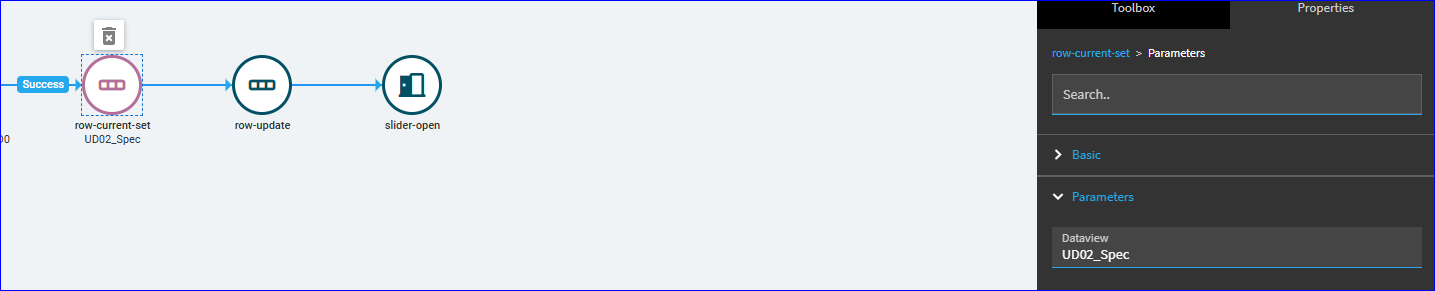

On Success of creating the new row… use the row-current-set in order to set that new row as the active row in your dataview (“UD02_Spec” in my case).
Then use the Row Update to set any keyfields you already know for the new record. I would assume your Key1 would be your PartNum value.
I then have a slider-open as my data entry fields are for my UD table columns are on their own page. If you are just adding additional fields directly to an existing Part Entry page, you won’t need that.
At this point, I would test and verify in debugger that your event is firing as expected.

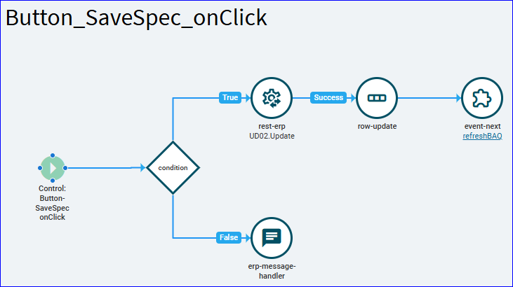

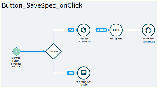

3. You’ll then need another button + event to Save the record back to the UD14 table. Below is what mine looks like:
I have a condition that checks that pertinent fields have values. If TRUE, it performs a rest call via the UD02.Update service.
The Row update in mine just sets a TransView flag I use elsewhere, and the refreshBAQ is used to help refresh some grids I have on the page displaying the UD02 data. You may or may not need those depending on what you’re doing.
