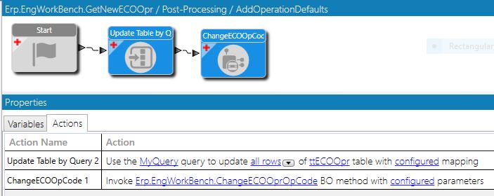

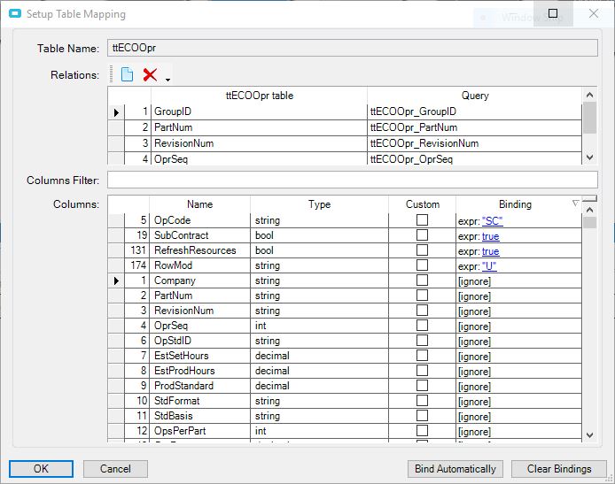

Here are the widgets that I setup in the post-proc of Erp.EngWorkBench.GetNewECOOpr
When I click Add new Operation from the eng workbench, the op is added and defaults assigned. This part works just fine by itself.

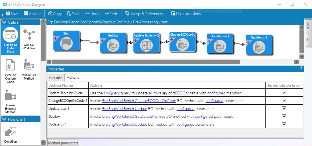

Here are the widgets that I setup in the pre-proc of Erp.EngWorkBench.EcoOprInitSNReqSubConShip
When this is enabled, and I click on Add Subcontract Operation from the eng workbench Action menu, a new operation is added, and then I get this error:

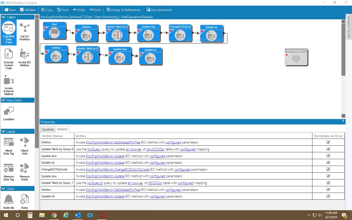

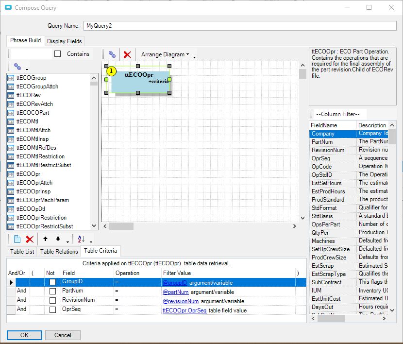

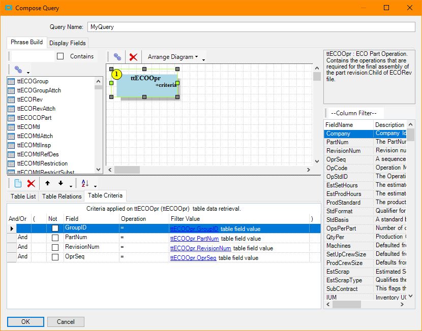

I noticed you can’t see which datasets I am using for each widget. Generally speaking, I create a new dataset when I getdsfortree. I call it dsw. This is the dataset I use through most of the directives. However, I also use the dataset ds (which refers to the ttResults data) in a couple of places. I am not sure on how or when to use existing or new datasets. IF you need more clarification on which datasets I used, just ask.
Thanks!
Nate
I think you are doing too many widgets :smile:
I see you are using the Update method. I would recommend that you let the user do that on the UI side instead. This is likely why you are getting the “ECOOpr has not changed.”.

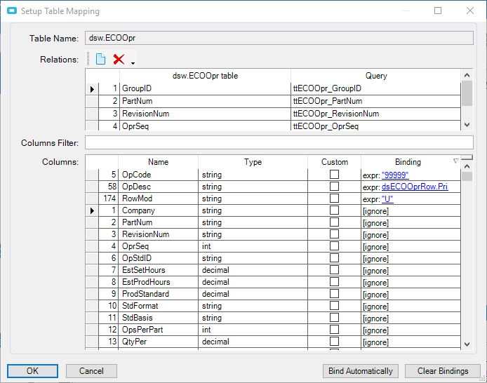

Remember, you are only trying to default the OpCode (and OpDesc). This can be done with a single Set Field and and single BO Method call.

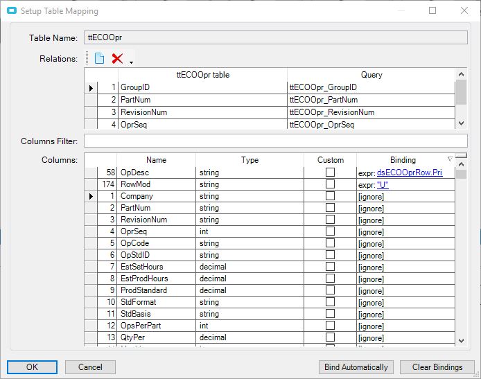

When I try to do everything in one call, the description is not updated.Going back to the post-proc of Erp.EngWorkBench.GetNewECOOpr, I did just this:
I used only the internal dataset ds. But the description is not updated. Even after I click save or refresh.
That is why I ended up having to set the description in two steps, with one UpdateTBQ for the OpCode, and one UpdateTBQ for the OpDesc.
Not a huge surprise. What is the query doing?
Shouldn’t this just be a Set Field on the Added Row.
Either way, if it doesn’t populate the description, you could use the Update Table by Query to get the Description.

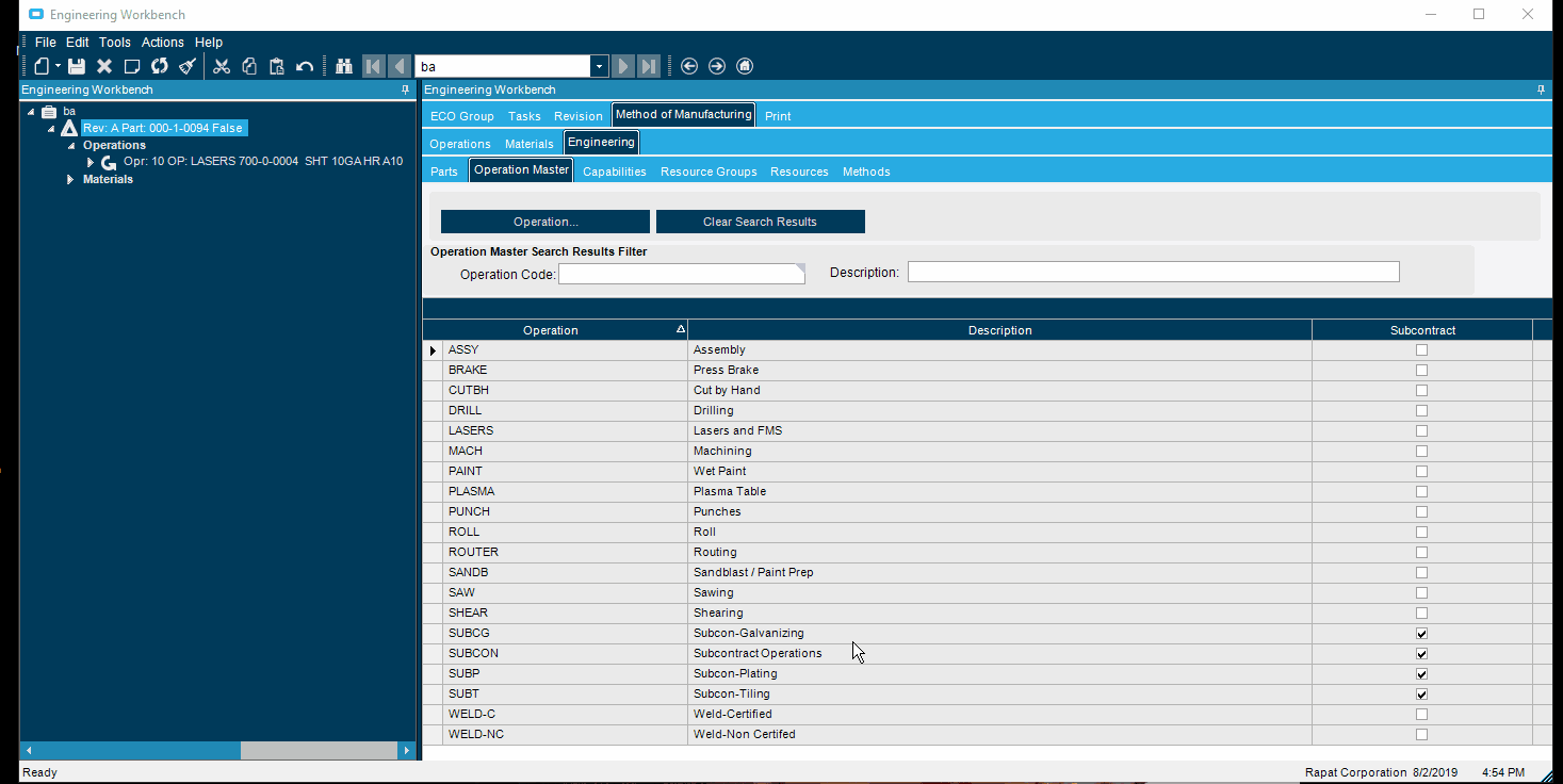

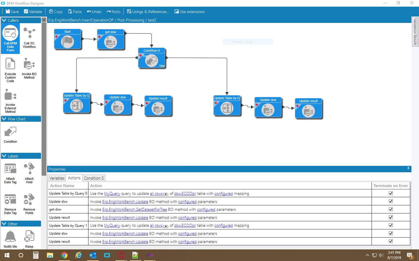

I ended up trying @Banderson’s idea. Making the engineers click and drag their ops into the list. I noticed this fired a different method that I could access the OpCode in.
The original request was to set some default fields depending on if the user added a regular operation or a subcontract operation.
For the regular operation, just update the OpDesc field to match the PrimaryOpDesc field.
For subcontract operations, just update the OpDesc field, and set DaysOut = 5.
I accomplished this nicely with a post-proc directive for: Erp.EngWorkBench.InsertOperationOP
Thanks for your help!

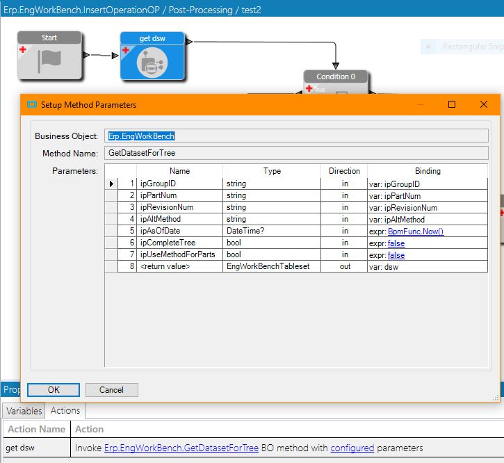

I have been searching for weeks now for something like this. I have a bunch of parts that I need to update the Days Out based on the vendor. Your example is the closest thing I have found to accomplishing this. Could you explain to me what you are doing in “get dsw” and your “condition 0”? Also, if you have any suggestions on what Method would be best to build this post process on, I am open for any help possible.
Hi!
Get dsw, just creates the dataset “dsw” by using the GetDatasetForTree BO method.
Condition 0 just checks the opcode, and if it is “SC” (subcontracter) then, it also asks the user how many days out, as this is a field that must be set.
To find the best method, run a trace to find what methods fire when you execute the process manually.
