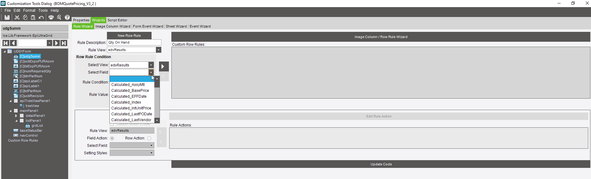

I have a task to add a new column into a menu that has been customized, how can I add a new field to an existing view?

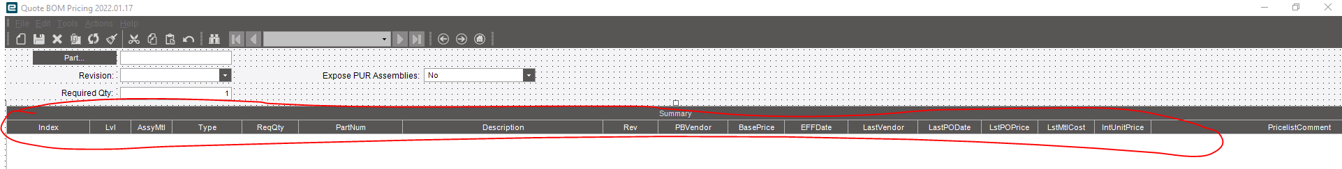

The menu is the Quote BOM Pricing Menu. Beow SS is what fields currently populate.
I can see these field are coming from view “edvResults” as SS beow shows.
I need to add another field that is Qty on Hand, but that field is not available in the field drop down menu. How do I go about adding this field to this view?
