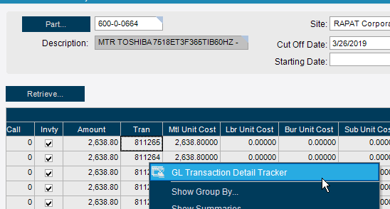

Can you find the GL tran column (you may have to unhide it, it’s labeled “tran”) and do a right click open with and see the GL transaction?

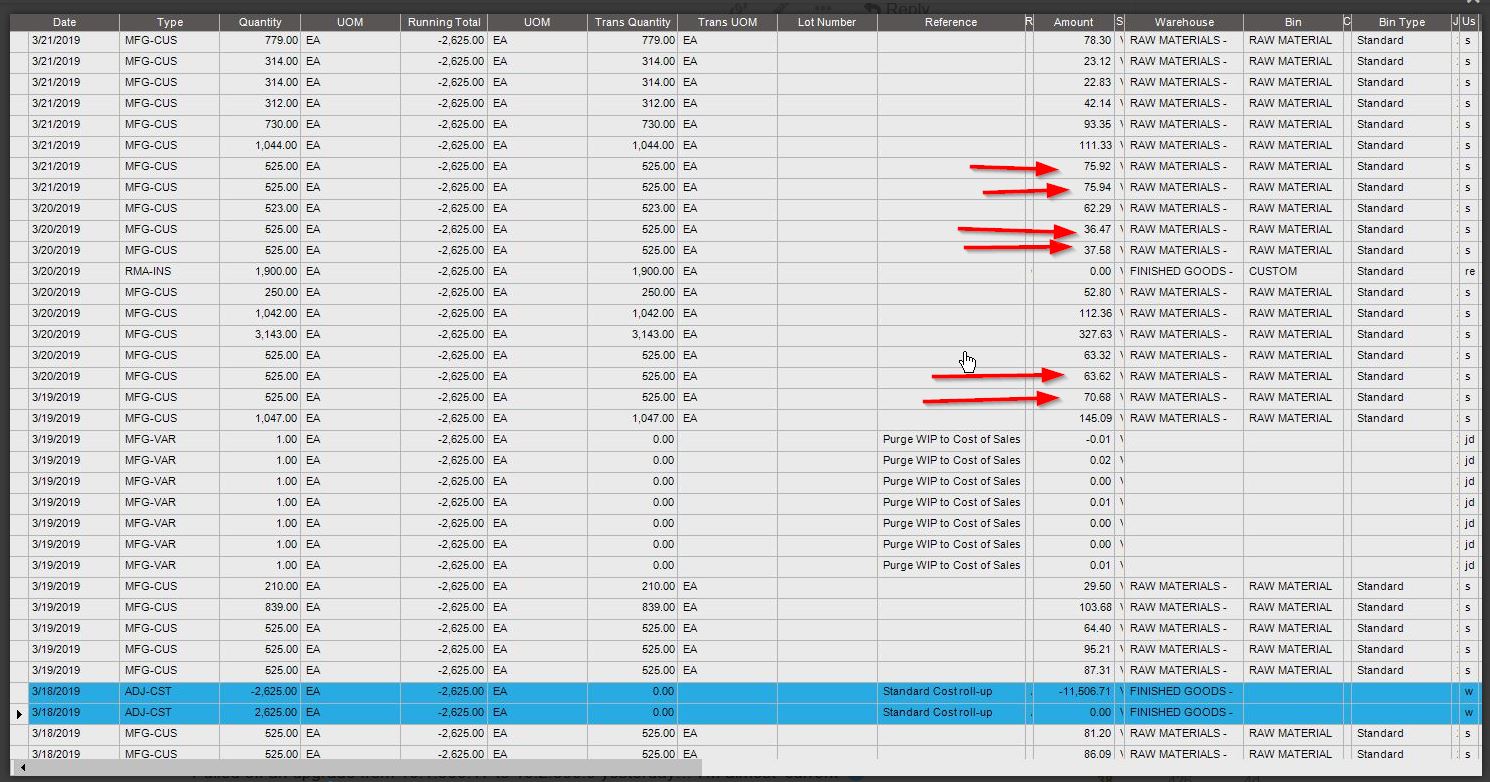

So, If I fix the Running Total, that should fix the other issues?
Fixing your inventory is always a good idea. How you fix it, depends on a lot of things.
Well, this part should always have a running total of zero. How would you approach this?

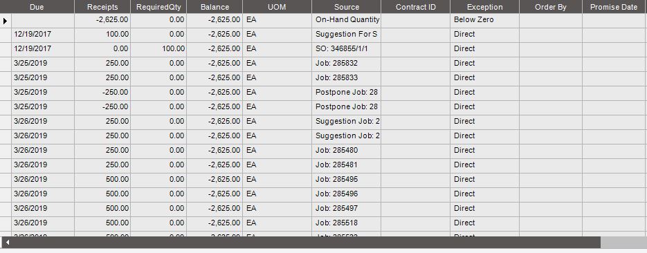

First look at time phase, and see if anything is open that just hasn’t been finished yet. (Like @ckrusen said earlier) if you can do the any reciepts to inventory from jobs, that’s the best way to fix it. But if the jobs are already closed and gone, then an inventory adjustment. You will have a GL transaction follow that when you do it, but, again like @ckrusen said, it’s probably already in variance anyways.
Can you look at the part tracker on this job and look at what the costs are? And double check and see if this is a standard costed part?
Also, please look at the GL tran like I wrote before. You want to double check to make sure that part transaction actually hit the GL.

It is STD cost. I’ve never heard of GL Tran. All I see is GL Tran Matching or GL Tran Type. Here is the time Phase for this part.

I did that and it says No TranGLC entries were found for this PartTran for GL Book Main Book. I did this on the Tran Number for the Cost Rollup -2625.

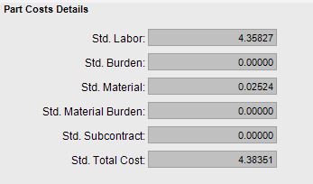

Also, Can you post of screen shot of the current cost on this part?

There’s your 11K 4.3851 * 2625 = $11,506. You went from 0 to this. Cost adjust back to $0 and it will undo the adjustment.
