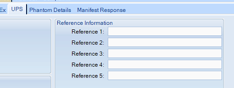

There are four reference fields in the facilities setup you can set for all shipments.
The four reference fields in the UPS tab are used for all carriers. I believe you can override the defaults here.

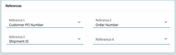

Thank you! Do you know if the reference fields would just show up on the labels or would we need to configure the label for it to show up?
if you set them they are sent to the carrier and come back with the label data they send back from what I remember they just happen.
We tested a few and it works! Thank you so much for the update
