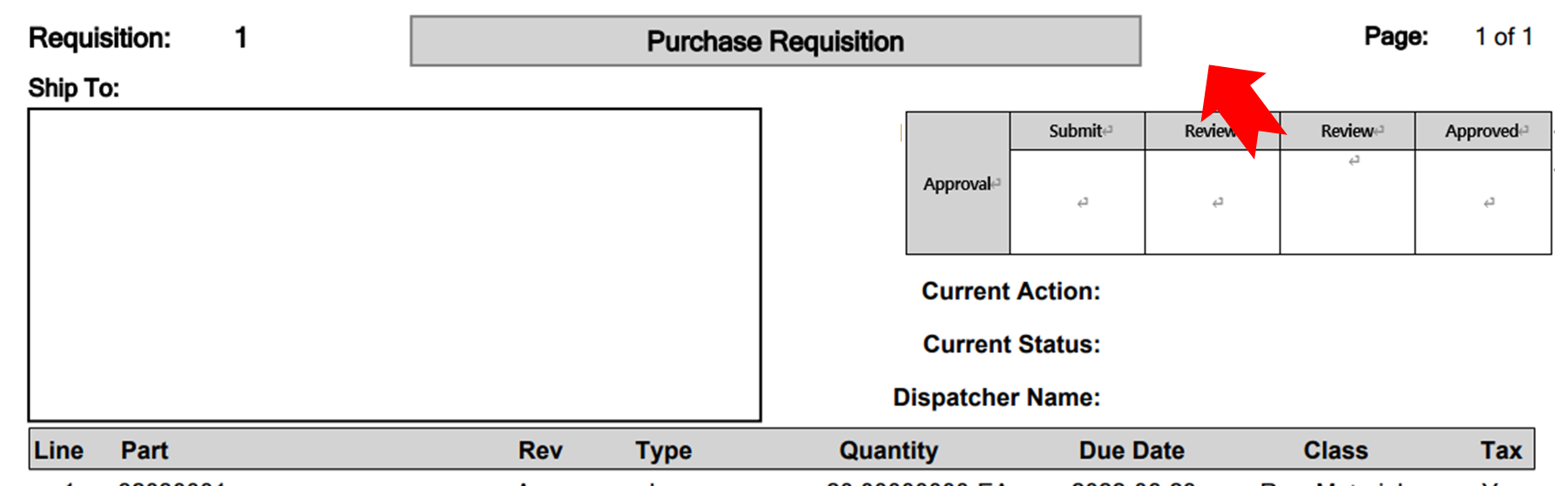

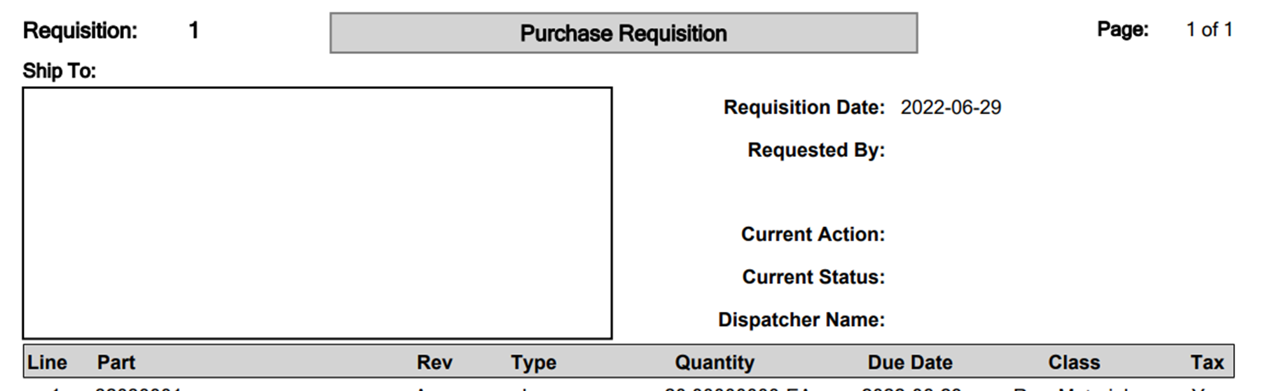

So I want to use the Requisition’s Print(Actions>Print). Currently, when I output it, it is output in this form. I want to add that approval box here as in the example below, can I do it?

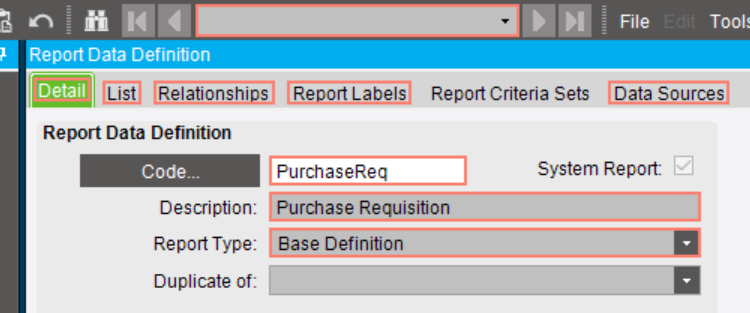

Once you were familiar with report modification processes… then (I think) you’d just need to make sure your checkbox field is enabled in the RDD (PurchaseReq) and then modify a duplicate of the report style “PurchaseReq”

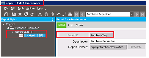

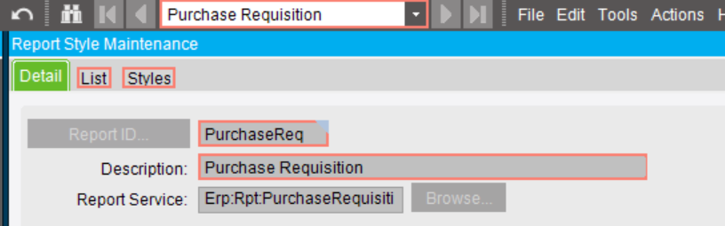

My screen appears like this, is it not possible to edit?
