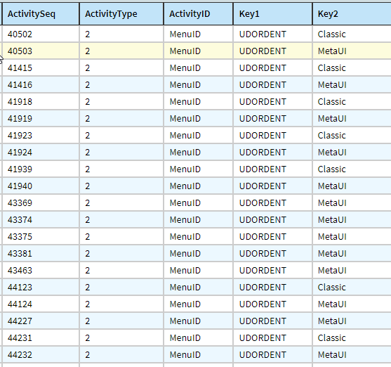

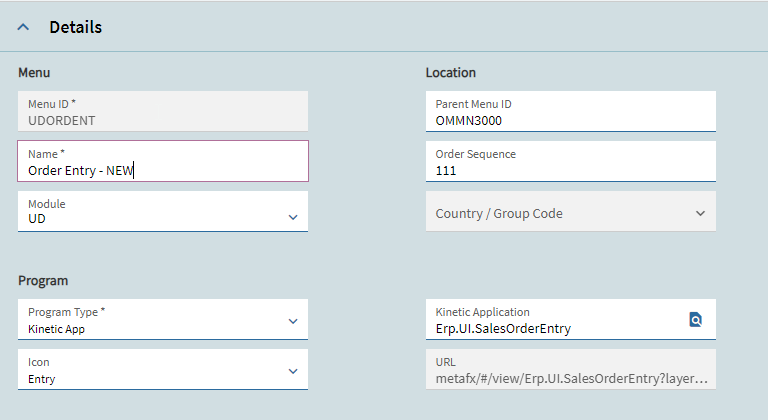

I have a UD menu item to run a customized kinetic version of order entry. As far as I can tell the menu item only ever launches in kinetic. But activity tracking has two records every time this screen is launched, one says classic and one says metaui. I don’t know if this is a bug in activity tracking? Something to do with UD menu items? We are trying to use this to figure out who is still using classic forms so its not very useful if it tells me they are using classic if they aren’t.

The table is ice.sysactivity

So this is entirely reproducible. I can’t tell if its a bug or working as designed because I can’t even get support to understand the question :sob:
If you create a new menu item as a Kinetic App.
Launching it from the browser: You get MetaUI in key 2(correct) and Desktop in key 3 (um what?)
Launching it from the client: You get Classic in key 2 (NOOOOOO) and blank in key 3 (why?)

I WANT to be able to clearly see who is using kinetic and who is using classic. This completely blows that up because it is capturing a value of classic instead of metaui when the user is, in fact, using the kinetic interface.
