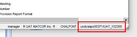

If you can programatically read the “server” value displayed in the status bar:
You could get closer to being universal, if you assume that the APP is deployed to
`“C:\inetpub\wwwroot” by using:
string srvapp = "usdcaaps00371/UAT_102300";
string srv = srvapp.Split('/')[0];
string app = srvapp.Split('/')[1];
string pth = @"\\"+srv+@"\c$\inetpub\wwwroot\"+app+@"\server\web.config";
webConfigText = System.IO.File.ReadAllText(pth);
And if you were really ambitious, you could use functions like Directory.GetLogicalDrives(), Directory.GetDirectories(), etc… to search and find the web.config file.
Just need to figure out how to get srvapp

That was for server side BPMs. Here is the client side code:
Ice.Core.Session currentSession = (Ice.Core.Session)oTrans.Session;
string erpEnvironment = currentSession.AppServer.ToString();
You may need to play around with parsing out the string depending on your server name
