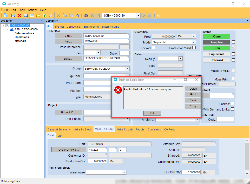

A valid Order/Line/Release is required. Will not let me create a Demand Link > Make To Order
I created my first three Sales Orders for Repair jobs. I learned today, that each of these orders needs a job linked to them. All three jobs are closed. So, I started with the first job and reopened the Sales Order, reopened the Line and reopened the Release.
I have images of these following steps attached.
  1. Open Sales Order 447292
  2. Notice: Line 1
  3. Notice: Release 1
  4. Right click on the Part and select Job Manager

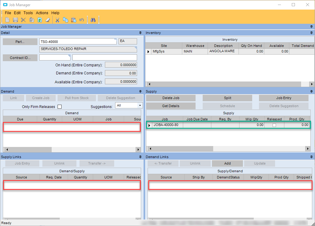

  5. Create Job is grayed out. So, I create the job via Job Entry
    6 & 7. No Supply or Demand links show in Job Manager.

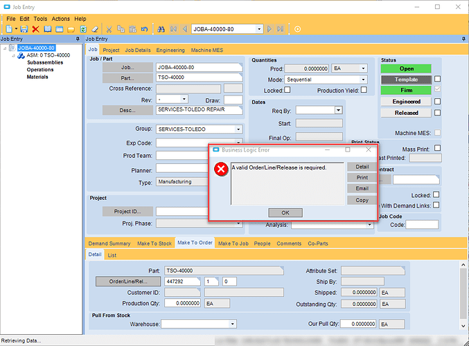

  6. So, I attempt to create the Demand Link > Make To Order. I enter 447292, 1, 1
  7. I get the error message: A valid Order/Line/Release is required.
How is it the number I entered is not valid? The Release is marked “Make Direct”.

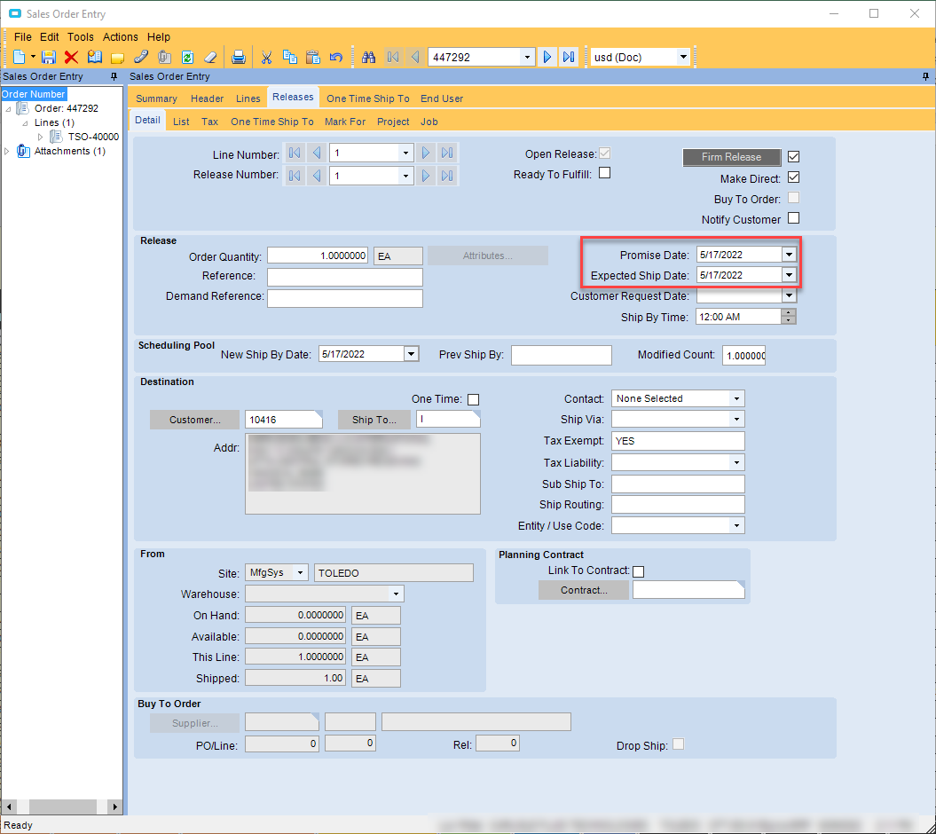

  1. Can you show us how the Release tab looks like
  2. Instead of typing it when creating the link, can you use the button and search for it and select it.

  1. I have attached a screenshot of the Release tab.
  2. Neither search/select or typing works. I still get the error message.

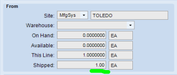

I’m with @Nancy_Hoyt here, you have a shipped qty of 1, so something is up there. I imagine this could be taking up all of the demand.
Not trying to distract from the FS discussion; we don’t use it here, but maybe it’s a better solution; maybe not. But as to the original question, I’d start with the shipment.

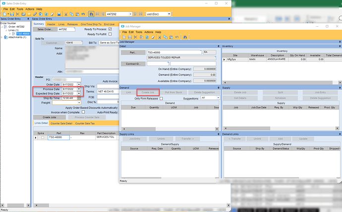

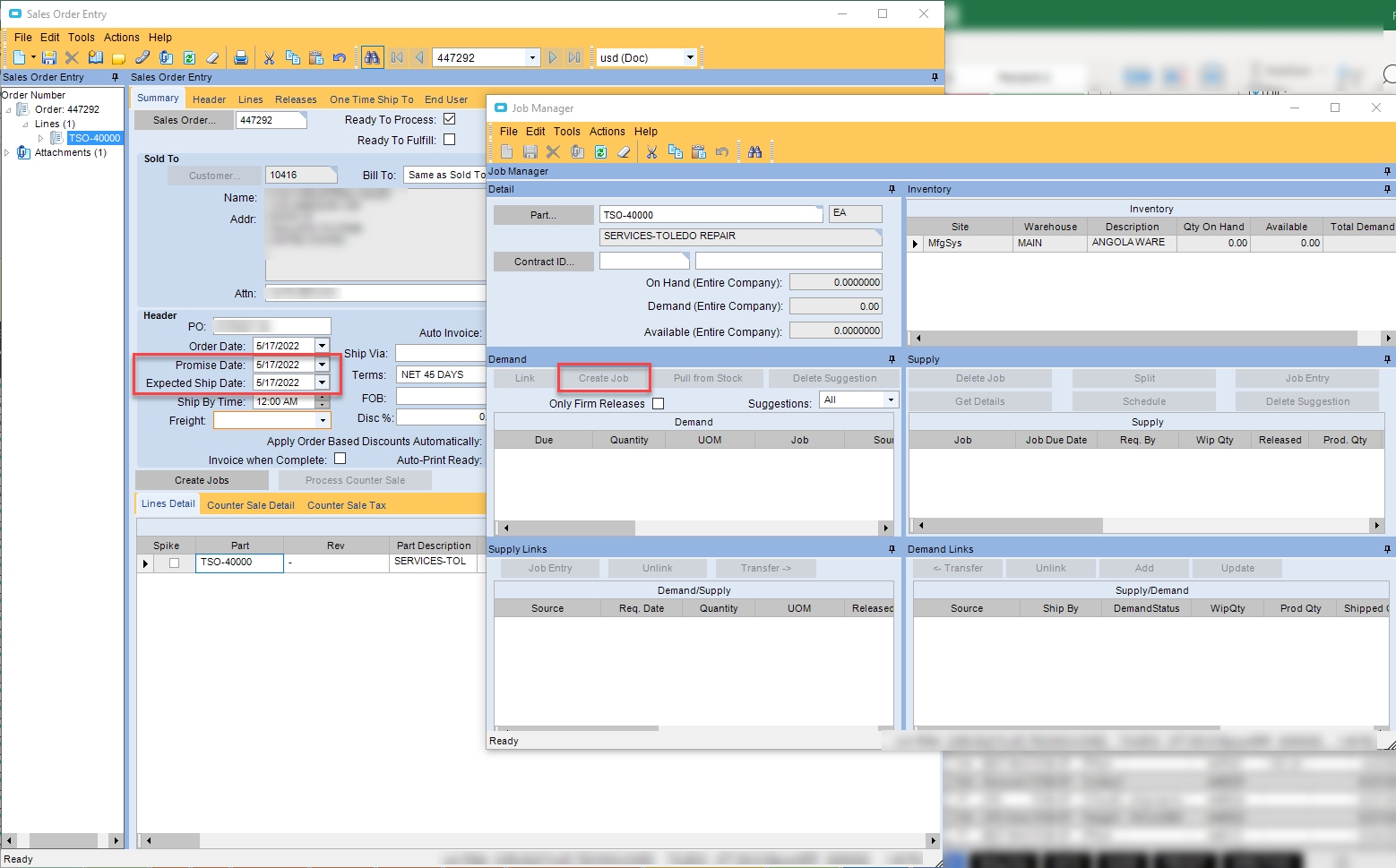

Ok, so I entered the order in the system on 5/17. So, per your suggestion, I went back in and entered 5/17 as the Promise Date and Expected Ship Date. However, it didn’t work. Notice the screenshot, I still cannot Create a Job via Job Manager like I normally can do.
Add the dates to the Release Line not Summary. Make sure Release has dates.
Ok, so I did that…
Then, I went back to Summary > Part > right click to Job Manager and it is still grayed out.
So, I went to Job Entry and created the Job from there, but when I try to link it to the Sales Order via Make To Order, it will not accept Order/Line/Rel…
So, I go back to the Summary > Part > right click to Job Manager and the Job appears, but of course there is no Demand Link. The Job is linked to the Part TSO-40000, but not to the Order 447292.

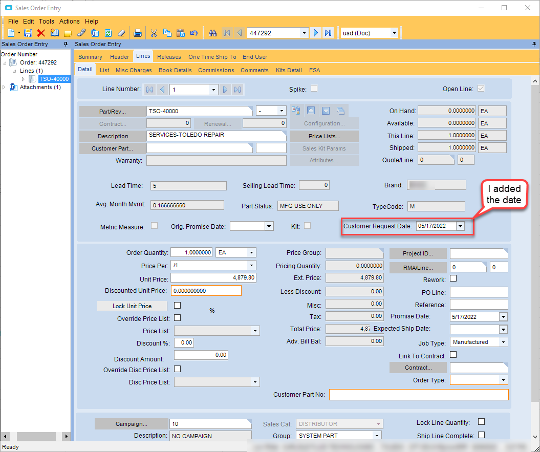

Can you also fill in the Customer Request Date. I have a hard time knowing what is a Need By Date and what is a Ship By Date as you guys have changed your labels.
Basically the date’s will drive Time Phase and Demand and the Firm drives Suggestions…

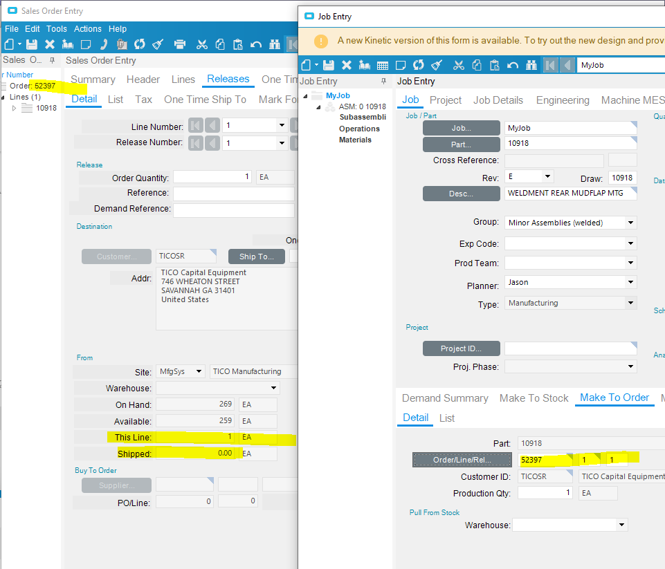

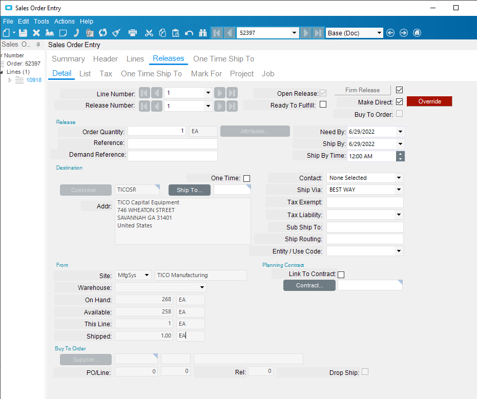

OK, really, it’s the shipped quantity. I tested this.
In this pic, I had:
  • Made the order for 1 EA of the part
  • Shipped it from inventory (this closed the order)
  • Reopened the order and line and release

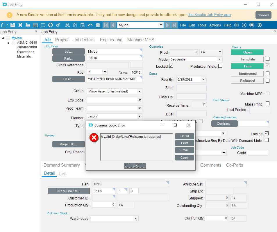

Next I make a job and try to add a demand link but I get the same error you did:

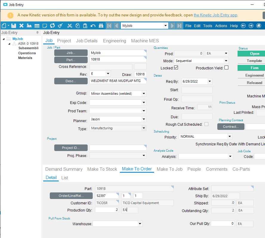

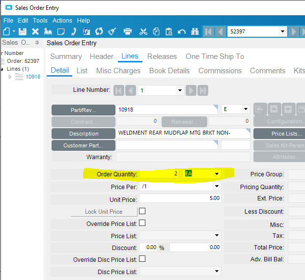

Now, don’t try this, but to prove a point, I change the order qty to 2:
And now I can add the link to Job Entry:
But more to the point, in a separate experiment:
  • I deleted the demand link I just made in the job
  • Set the order qty back to 1
  • Deleted the shipment
  • Added the demand link again and it worked again

With that said, I’m looking at the Lines and see Customer Request Date, I entered today’s date.
Then I opened Job Entry and tried to link it to this SO via Make To Order and no luck.
