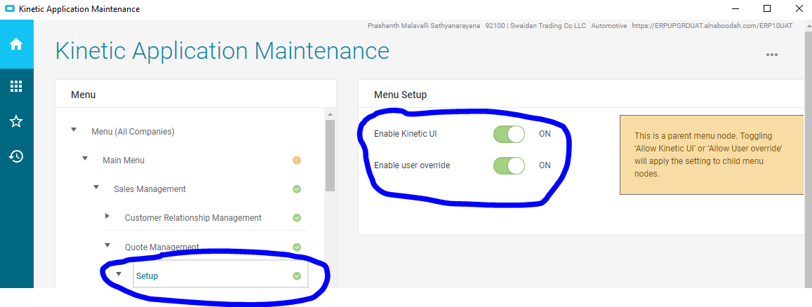

We are testing 10.2.700 and keep seeing “A new kinetic version of this form is available” on certain forms. For instance, Purchase Order Entry. We have customizations on the standard form that are not available on the Kinetic form, so we turned off “Enable Kinetic UI” in the Kinetic Application Maintenance tool. HOWEVER, users still see this “A new kinetic version of this form is available” banner on the top, allowing them to click it and launch a Kinetic version that does not include our customization.
Now, they can click “snooze”, but they could ignore that and still open the Kinetic version. How do I hide this banner from all users? I thought the Kinetic Application Maintenance tool would take care of this… is there somewhere else??

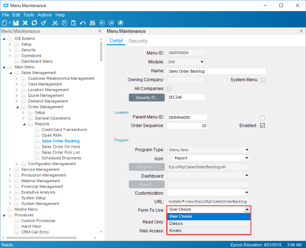

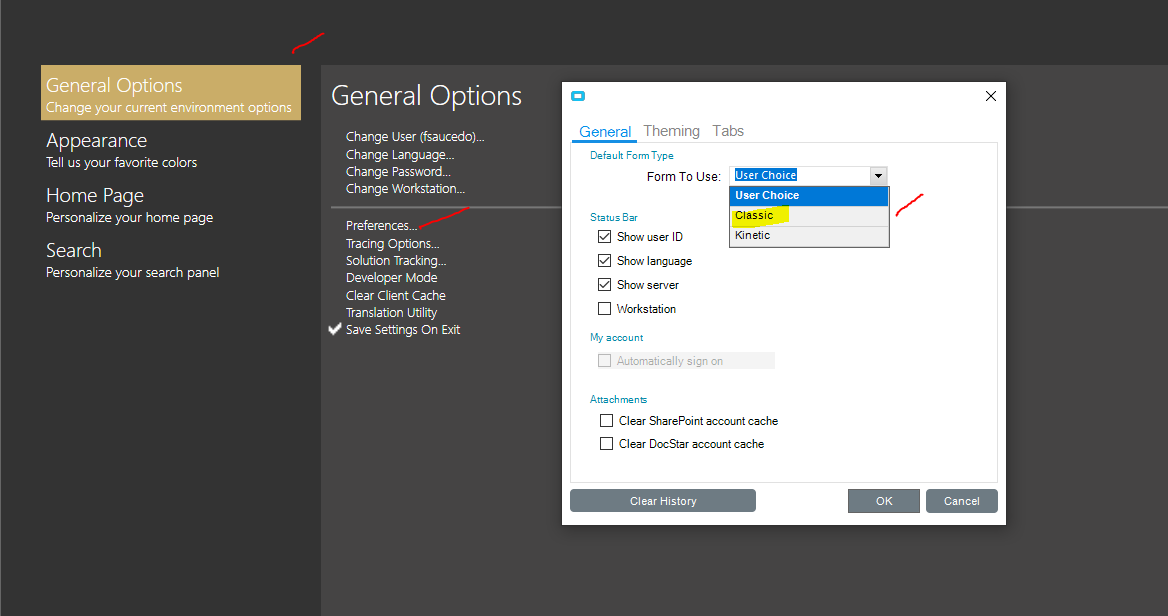

Okay, I was able to replicate the issue as well. The previous screenshot must only work for forms such as “print”. You can also try this it a the menu item level.
Yup. Tried that as well. Those choices will make the user open the “Classic” or the “Kinetic”, and that works well… but the problem is that when they open a classic form they still get the banner asking them to try Kinetic (which we don’t want because it will be without our customizations)
