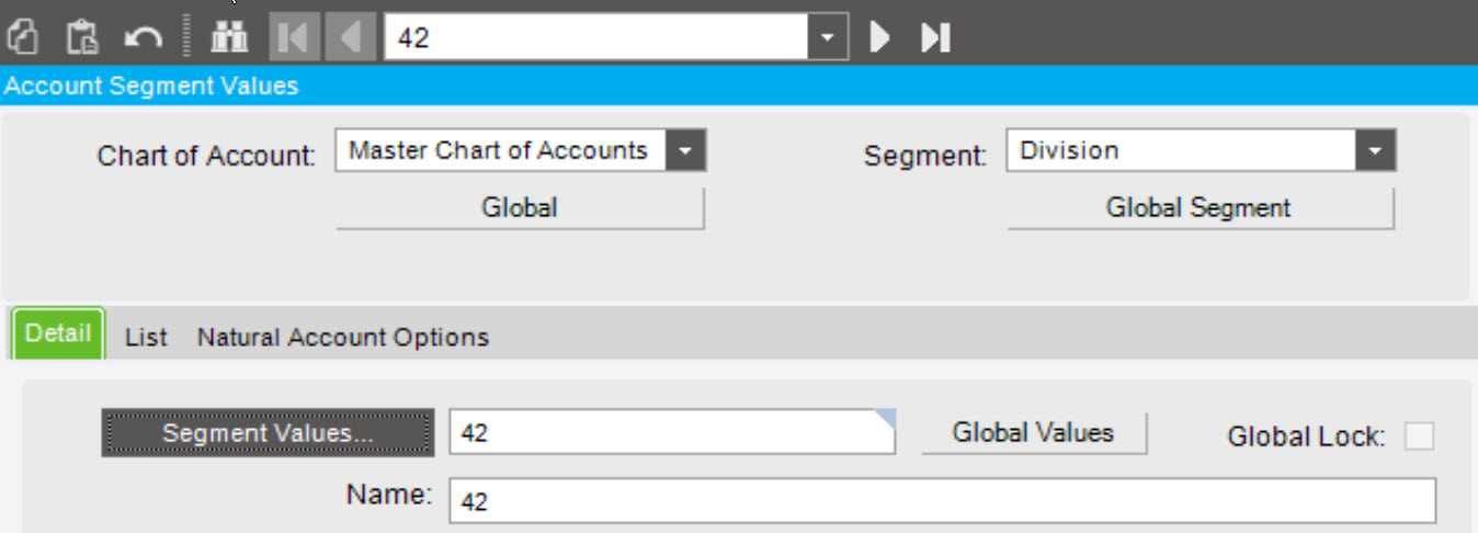

Using out of the box capability try using the flexing of the division
Here’s an example for two different warehouses.
How would one set that up?
To setup flexing in E9 or E10 follow these steps for departments or divisions.
  1. Setup values for the division segment
  1. Setup a complete account number(s) with the new segment value(s)
  1. Setup a Division GL Control
  1. Link the GL Control to the warehouse
That should do it, make sure that you are using the standard posting rules as the extended will not flex the segment
