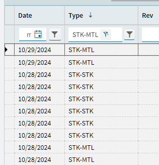

Part Transaction History Tracker - Cant filter

You should be able to filter. Did you turn off progressive load?
The problem I have with part transaction history tracker is that it often doesn’t load at all. Of course I can’t reproduce it so support won’t submit the issue but it makes the screen effectively useless when on any given day it decides it won’t give me any data.

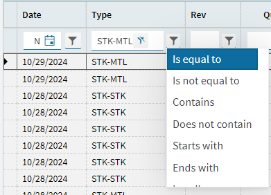

this is the issue
It defaults to “Contains.”
Try “equals.”
*Edit–Actually, yeah–I just tested my 2024.2 version and it works just fine with both. :thinking:
Both Contains and Equals works for me… that’s odd.

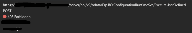

Has this update broken anyone else’s configurators? None of ours will fully load anymore without getting an error. Before this upgrade they used API v1 to run User-Defined Configurator methods. Now it looks like they changed it to use API v2, but didn’t update their calls to include an API key. So now, every call to a UD method bricks the configurator. I’m not seeing anyone mention this, so I’m wondering if this is a problem unique to us.
yep its broke!
Need more words lol. What is the problem?
Filtering STK-MTL
But returning STK-STK mixed in the results.
